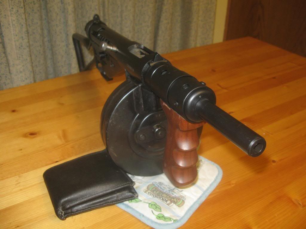

    This half sten can also be configured different ways.

    It has a sten rear end and a suomi front end with a purpose built hybrid receiver. Being open bolt giuns thay can not be exported to the US.
    Here's another variation.

    aww man cool did u make the suomi mag well?

    Quote Originally Posted by Patrick Floyd
    The part that is newly manufactured is the receiver. It's 1 1/2" longer than a standard suomi receiver to allow the sten sear to be positioned in the correct place. ( same place as a standard suomi ) The MkIII sten trigger housing has had a section removed in order to reduce the diameter to suit the narrower suomi diameter tube. The bolt is a suomi bolt that has had a hole drilled for the sten cocking handle, and the return spring is sten.
    Anyone who can build a suomi and a sten from parts kits can build one of these. I know it might appear complex but really it's not.
    The only problem with it is that it's heavy, turns heads though. Most peoples reaction is....

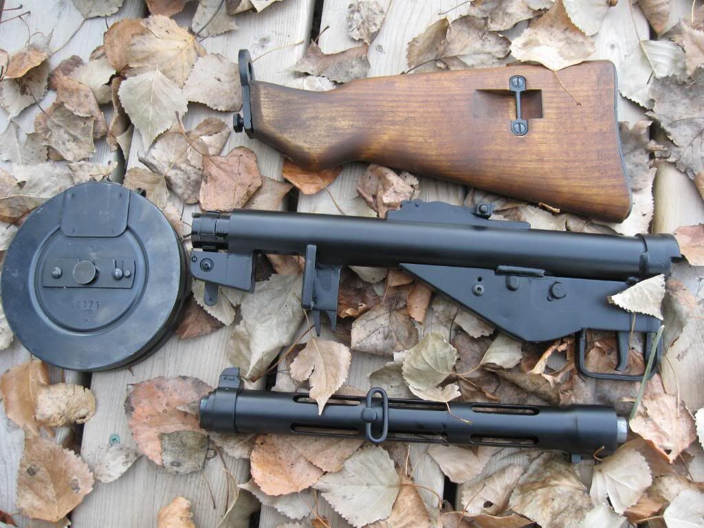

    You did a great job on it! I have a few suomi kits laying around I might take a swing at it...i'll be bugging u for tips lol

    I'm happy to give you all the tips you need, just ask.

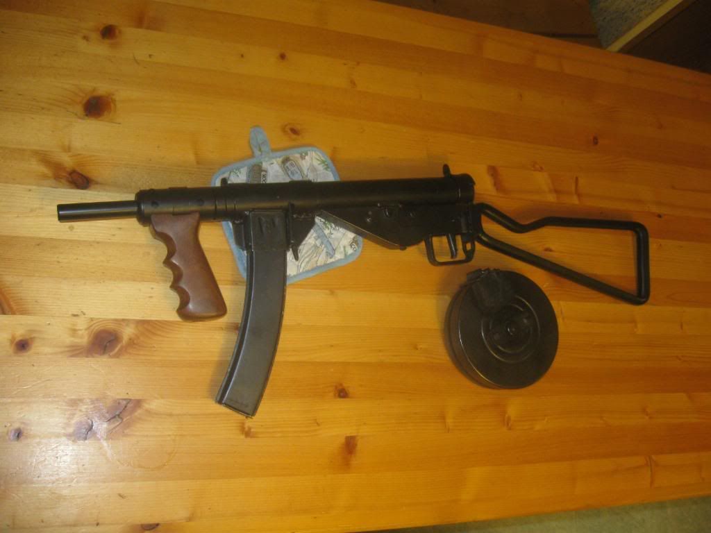

    How did u make the mag well? from a blue print? Thanks you do great work!

    It's a suomi magwell thingy. I was going to make a "magwell " but decided to use suomi parts as a barrel latch was already built in.
    I have built them from angle iron in the past. They are a bit of a PITA but they don't cost much to make.
    Here's one that allows a vertical sten to use ppsh mags.

    The mags work with 7.62 X25 and 9mm. All you have to do is swap the barrel.

    what about the bolt? man...time the fire up the mill and old tig rig!

    Cut it and turn it 45 degress so the ejector is uppermost, then weld it back together again.

    ak grip yessss lol
