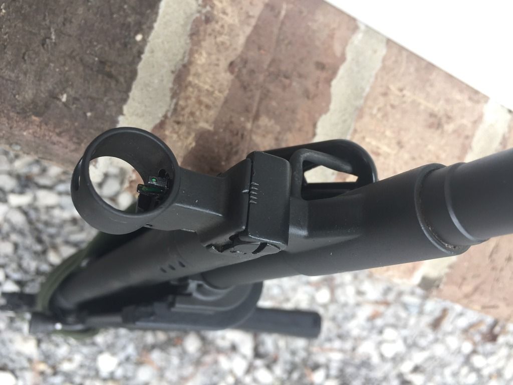

    Swapped out the factory front post for a fiberoptic ak sight had to alter the profile together it to screw down far enoght to sight it.
    Also fitted two orlite mags to work. Had to shape the front lip and shave off some of the back side. Also stippled the front and back of the mags.
