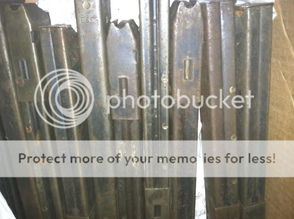

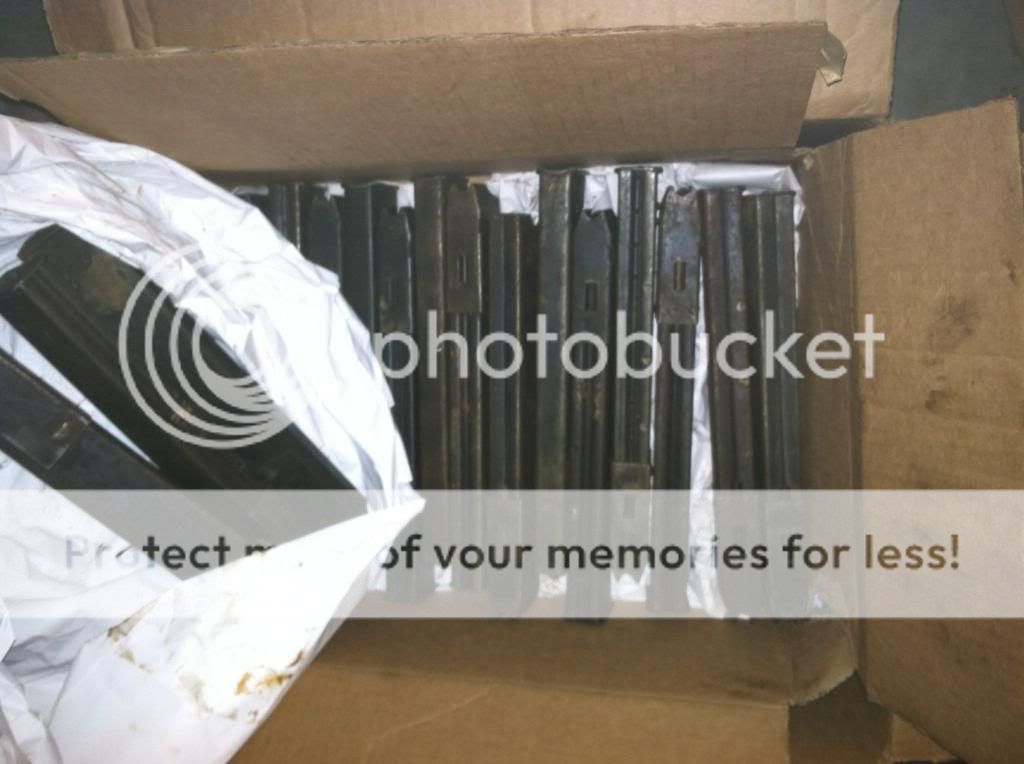

I just got them in they are rusty but 18/20 function smoothly, 2 have rough traveling followers. I cannot for the life of me see anything that limits them to 20 rounds!?

I just got them in they are rusty but 18/20 function smoothly, 2 have rough traveling followers. I cannot for the life of me see anything that limits them to 20 rounds!? Will try with ammo when i find some and update
