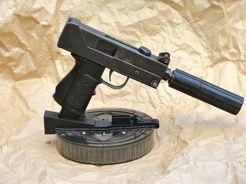

After seeing that picture I thought to myself "I didn't know stobro had a fleming upper". Then I was like, hey that table looks familiar. Then I finally realized that the table was mine as well as the M11A1 and upper. PICTURE THIEF!!! jk
9,125
Found it on the web as an example of how the Fleming upper was taller than OEM and the extended upper for the M11A1. SW 15-22 mags would not need a taller upper, but yes... I STOLE IT and there's nothing you can do about it! :)
I thought the picture was the gun was taken on their bathroom floor next to the toilet. I wondered if that was their review.

A short (non-extended Fleming M11-380 upper was offered for a time. The upper in the picture can be used with an M11/9 by cutting off the rear portion of the lug on the bottom. One part for two firearms - one less part to have in inventory - saves cost.
The 10/22 mag has the primary ejector built into the left mag lip. The ejector in the 10/22 receiver and Fleming upper is a secondary ejector that only sees use when the mag is removed and a casing (live or fired) remains in the chamber. An implementation of SW 15-22 (or standard AR-15) mags would need to have some sort of way to eject casings added in somewhere. Also, the mag catch actuation for the SW 15-22 (or standard AR-15) mags would need to be accommodated in some way that doesn't interfere with manipulation of the selector on the MAC receiver.

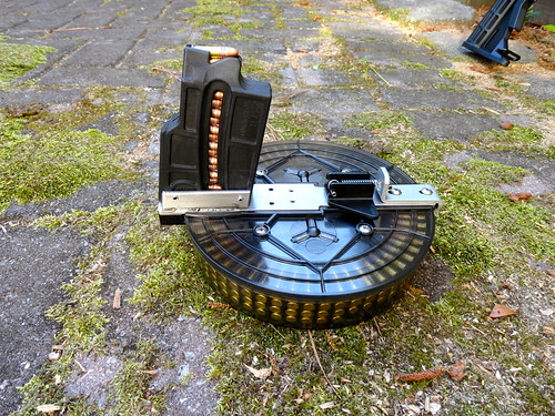

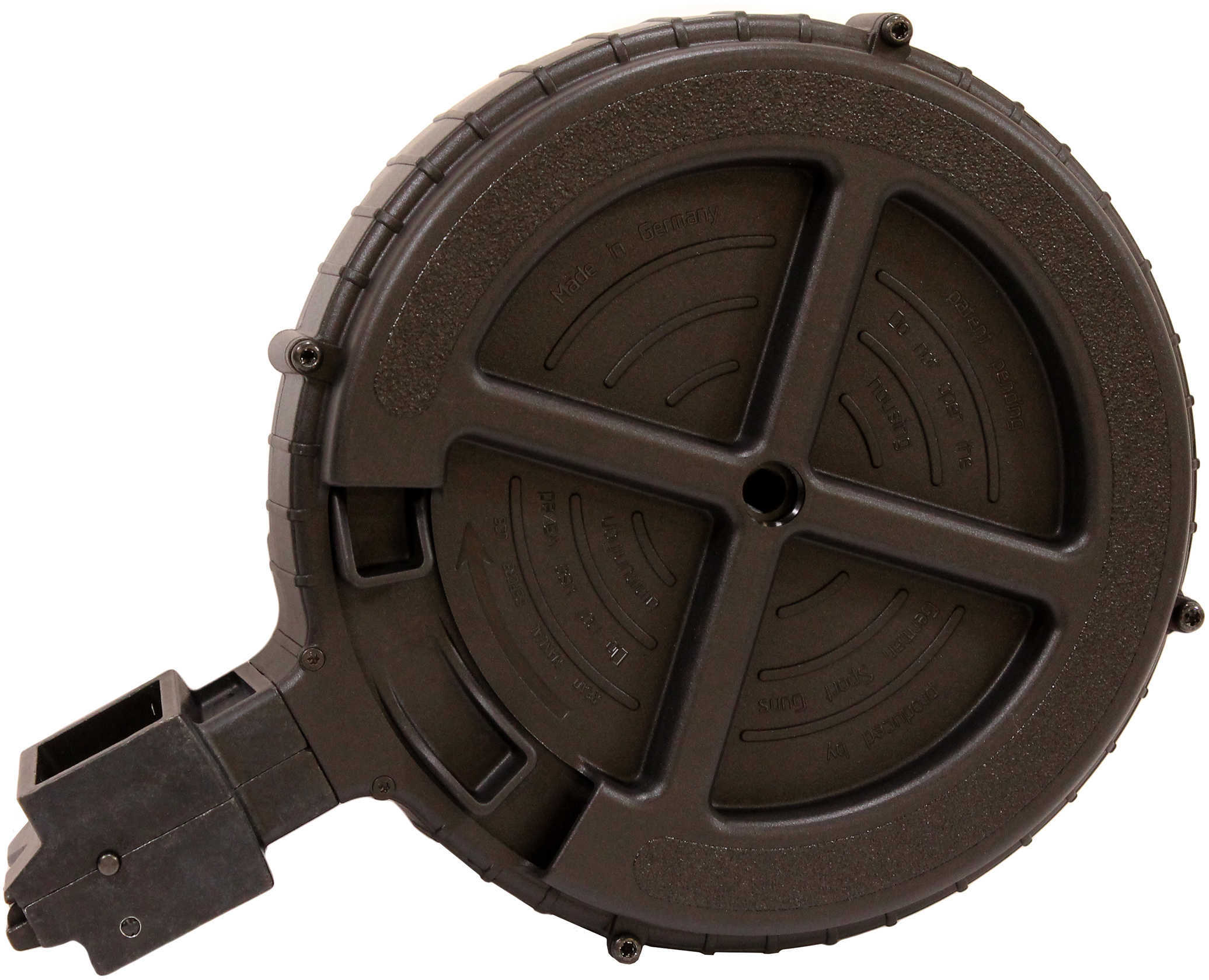

Roaster72, did you ever try the ATI 110 round mags or BDM or ProMag 50 round mags with the Fleming upper?

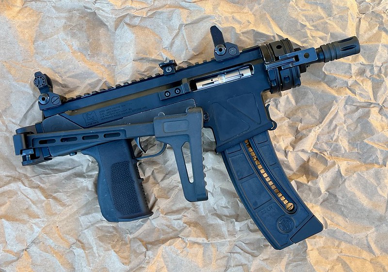

Here is my entries into the M11A1 22LR conversion. I modified the Richard's M-11/22 to a M-11A1/22 and Max-11A1 to use a modified S&W 15-22 parts and CMMG 22LR parts.
I think Richard should make dedicated 22LR AR uppers. I'd buy one. I'm sure he could slow them down more than my slowest one @ 1000 RPM;)

Strobro32, I'm not Roaster72 but I did try a GSG 110 round drum that looks very similar to the ATI shown (???). My M11/9 Fleming runs pretty well with RGB and a can or compensator but it didn't run more than five rounds at a time with the big drum. First I had to grind on it a bit to get it to fit and for the bolt to run over it. Might have been something with my bolt/upper/drum combination, I don't know. I tried running it drum up/ejection port down and still no luck. The drum didn't seem to want to keep up with the demand for ammo.
I had one of those Bazooka Brothers AM-180 adaptor and I couldn't get that to run either. I'm probably drum-challenged.
Dang, 22 ammo must be cheap where you live. That max-15 upper goes through ammo crazy fast. Very impressive!

tsmgshooter's video was the only video I've seen that the GSG 110 rd drum worked at lightspeed.
1743 RPM
