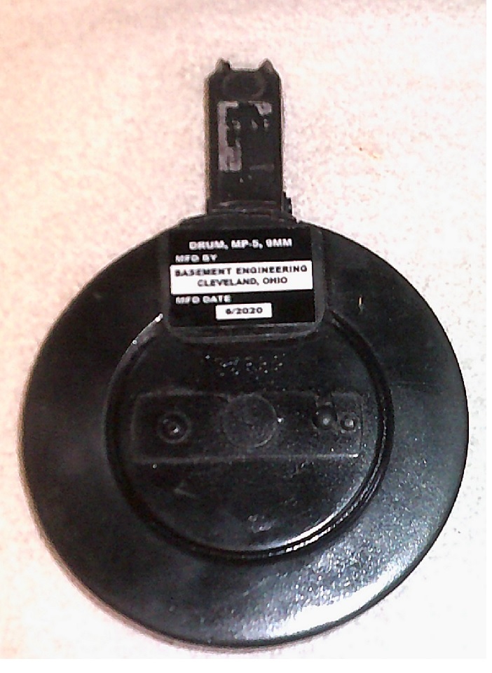

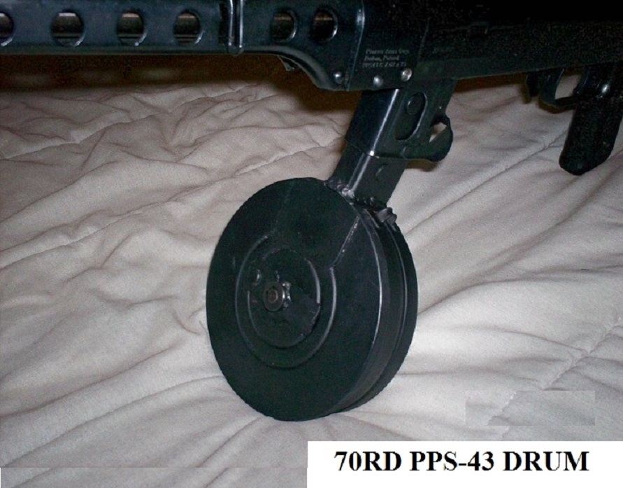

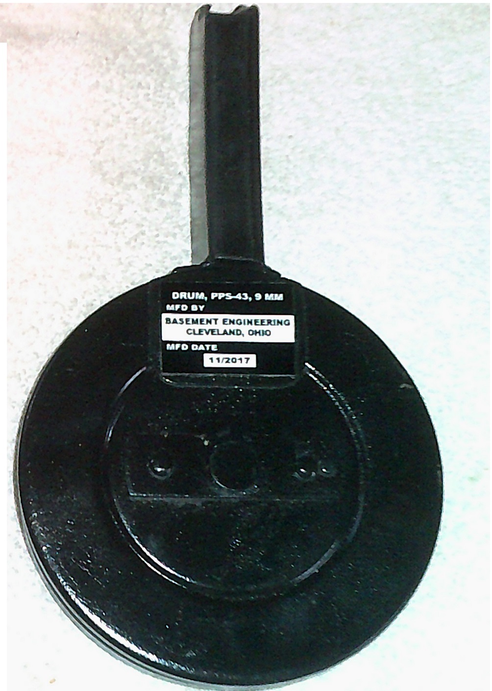

since I made that, I went on to make a 70 round drum for my 7.62 and 9mm PPS 43 using SUOMI and PPSH-41 drums and 70 round drum for my MP5k and they all function perfectly, because that's how I roll :)
