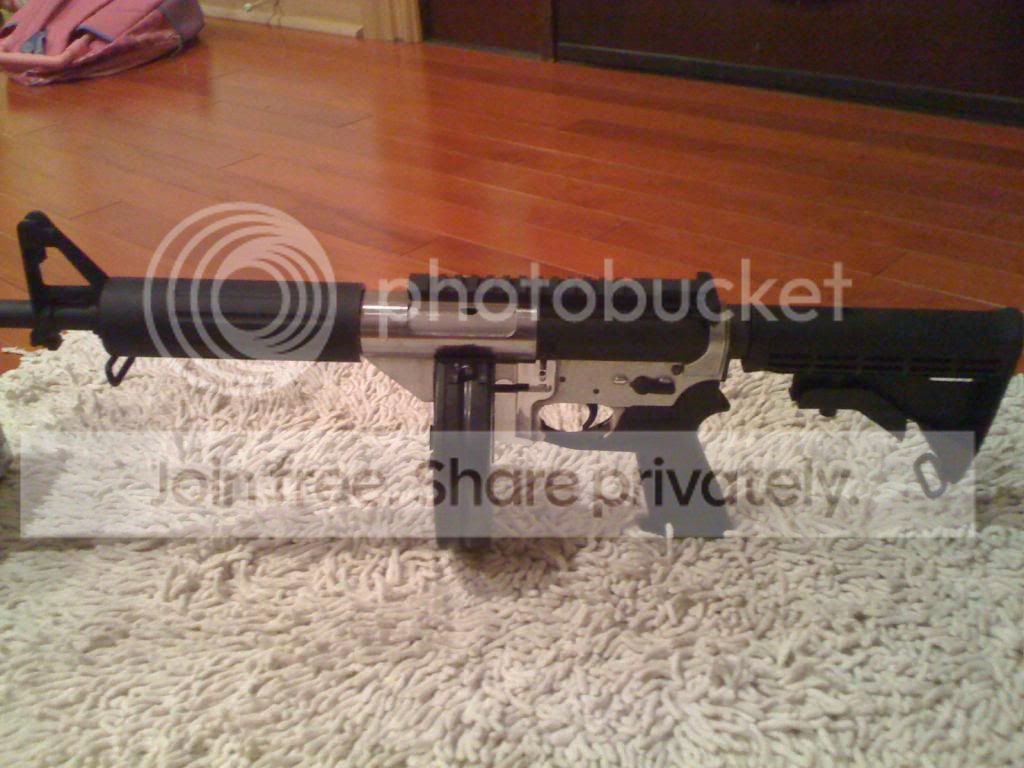

Hmmm, I have a PSA lower that the mags fit into. Maybe there's are made differently? The magwell has a little vertical slot running under where the mag release is. I'll take a pic later on tonight.

anymore info on the suomi lower
It looks like the magwell will need a couple slots milled in to allow the mags to fit. The location of the current slot puts the mags too far to the rear of the mag.
Plus the mag catch is an issue. I'm not a machinist which make it challenging.

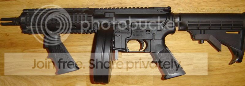

You have the pics to help with the drum angle already from the first link I posted.
Include those pics in your thread. A good machinist would have a good idea how to do those cuts from just the pic.
The first thing I'd do though, is try to contact the last company that made the weapon. They might just have some left over parts you can use???
This is a sbr model I found on the web. Best of luck and if you run into a problem, give me a shout.
