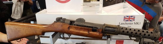

Nicely done! It's reminiscent of a Lanchester. A Stanchester? Stenchester?
940
With the wooden forearm that I made earlier it really looks like a Lanchester or other early European SMG. It hardly looks like a Sten in this configuration.

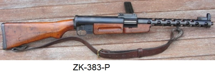

Or this Czech SMG (ZK-383):
