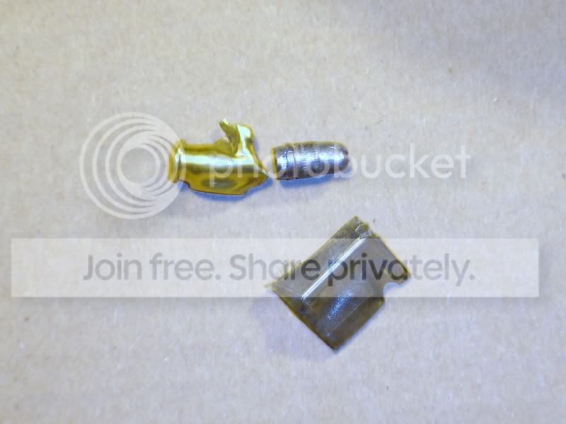

I had this OOB using Federal match in the 325 round value packs from WalMart. BAD STUFF that's not the same ammo as the 550 round packs! The OOB detonation cracked the feed "scoop" on my 220 round drum ending it's use until I get a new bottom plate.
