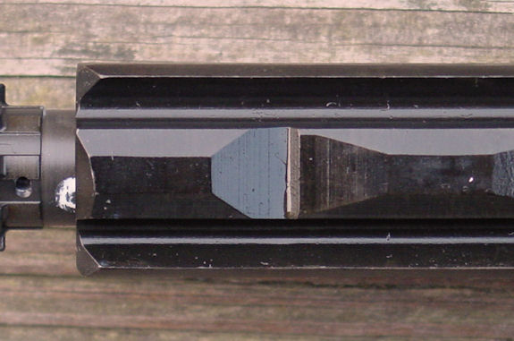

Godfather's upper was shipping this week. We should see several of these around the valley in the weeks to come.I spoke to Craig for almost 40 minutes and he's very confidant he's shipping a good product.
As you probably know, with the open bolt system the hammer becomes the sear, and the sear becomes the hammer... if that makes sense. Due to the work you had done on your gun, you may need to fit/file/remove material from your new sear.
With the open bolt FCG included with the upper, you can "notch" a 5.56 bolt as shown below, and have a open bolt gun in that caliber.

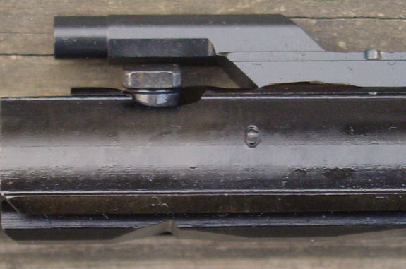

For .223 the hammer isn't hitting the firing pin with this TI FCG supplied..... The FCG supplied is for a fixed firing pin.
This "Sear Lever" might be needed to let the hammer go.. and it doesn't come with the kit. I don't have a open bolt FCG but it looks like it's needed... The carrier hits this sear lever and the sear lever rotates the sear. The sear rotates and allows the hammer to fall. Open bolt patent pics http://www.freepatentsonline.com/4433610.pdf
