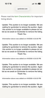

3,633
This is a vendor that knew EXACTLY what he was selling from the start.
Shady as hell and he knew it. Not an honest mistake.
Finally after countless people stating the facts they made this note to stop bidding.
Jtm35a2
Dec 20, 2020
309
Granite Falls, NC
^ this!
They were notified of the problem and failed to act until threatened. Imagine being the poor sap that bought it and went to prison. That seller deserves no quarter!
