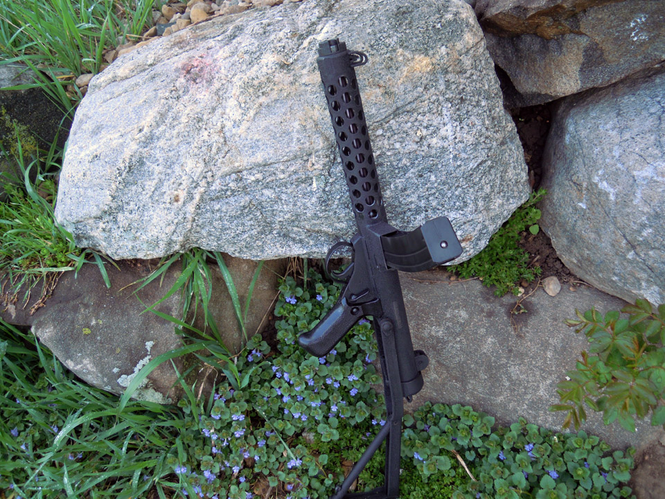

I just got my wiselite sterling back from KGB. Andy did a great job of mounting the barrel and fitting a end cap for $125. No bayonet lug, but it was a option. I was never going to mount a bayonet anyway.
Wow! That was a smoking deal!
Thanks for posting pictures. It looks very nice.

I know he had to mill out part of the breach end so it would fit over the blocking lug welded to the tube. He also sent back some parts that he cut off the front end to put his assembly on it.
