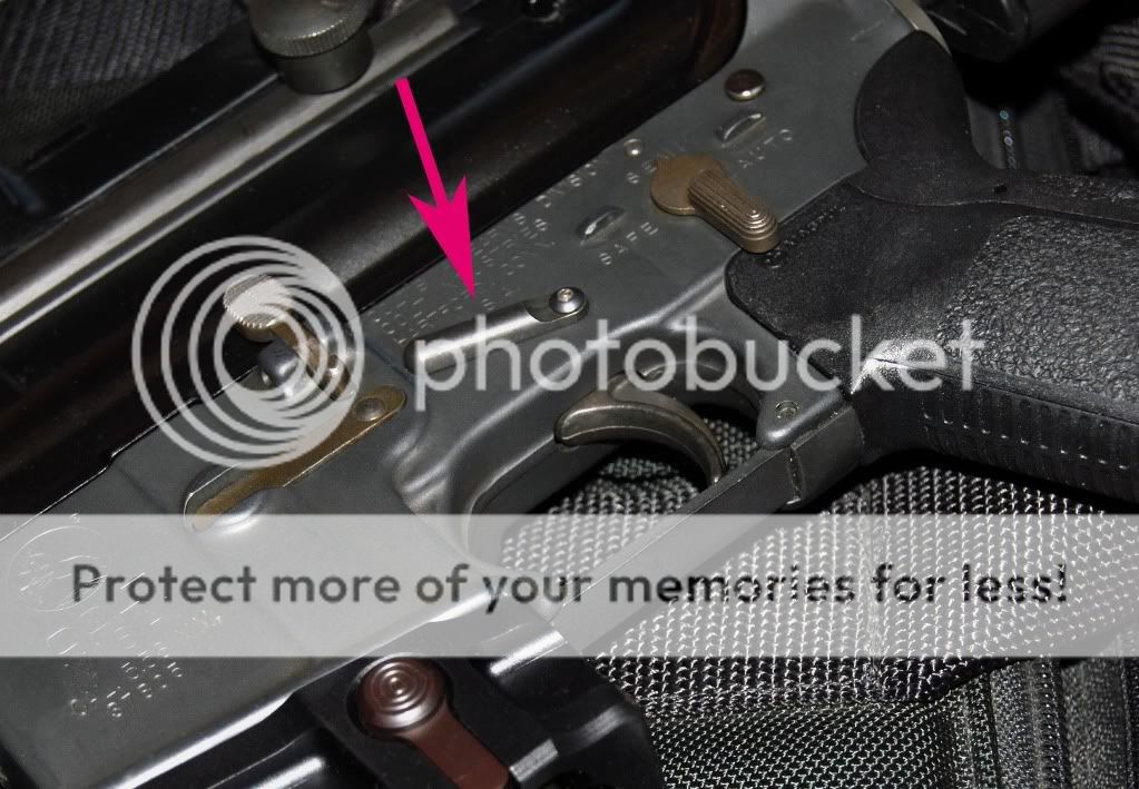

Chris @ KNS emailed me recently regarding a picture I had posted of my 9mm M16 setup. He said I should REALLY upgrade my Gen 1 KNS pins to the Gen 2 Mod 2 set. He said to see him at the upcoming (Jan) S.H.O.T. Show in Las Vegas. I picked up a set of the Gen 2s and came home and installed them ASAP. Chris offers this upgrade for only $20... CHEAP insurance for RRs or any AR/M16 lower. Just a heads up.
