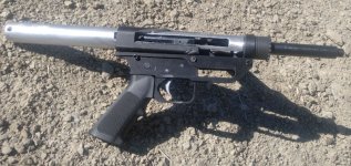

Here is my current build. I am currently in the proceas of getting way to carried away with altering the design. It started out as i wanted a 9mm ar15 that could interchange mags with my Uzi. Decided to print a lower, bought a stripped upper, then started coming up with crazy ideas. Thought it would be cool to print a upper, but for obvious reasons that would work, so then had the idea of inserting a aluminum tube in my 3d print. Then i reminded myself how I have always wanted a Sten... so i decided to flip the magazine on the side... which obviously the ar15 bolt doesnt work for... unless i modify it... i did.
This is the rough mockup. I am right now procrastinating doing some cad redesigns in fusion 360... obviously some of those parts arent fitting correctly.
The tube is extruded 6061 with a 1" id. Then i ran a reamer through it to get a uniform size (actual size before reaming was .987" ). I already ruined one upper i made before buying the reamer on virtue of the fact that the barrel was a wee bit snug.
I mentioned this was going to be a ar15 build. Once i can verify my proof of concept (ie that i can actually make this monstrocity work), im going to try welding one up out of sheet metal. Then the only similarities it would share with a AR is the trigger, feed ramp (colt style), and the magazine catch. Considered changing the mag catch to use the Uzi holes on the mag, but that would stick out quite a bit.
I painted it before I should have, so it looks like garbage. Oh well.
Overall length is about 20"

Sorry about the lousy pictures. Will get better ones when it looks better... like mebe when its actually all attached together
