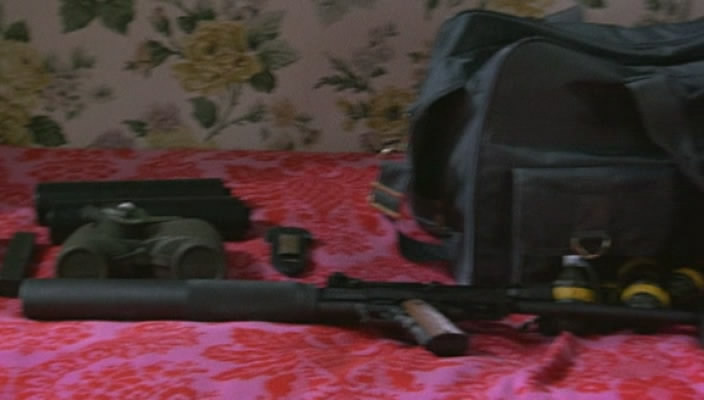

Safari Arms did something like this back in the 80's for the 1911. They called it the "Survivor" carbine kit. It was an unregulated upper that bolted on in place of the slide and barrel assembly. It was a manual straight-pull that fed from the magazine. The T-handle bolt would be pushed through to the other side of the upper receiver to engage a hole, and this was how the bolt locked. To cycle, pull outward on the T-handle to unlock, then pull rearward to eject the spent case, then push forward to feed a new round, then push inward to lock the bolt.
The kit disassembled with the stock and barrel detaching and all fitting into a nice compact stowable package. Unfortunately, Safari Arms must have made only a dozen or so, because I have been hunting high and low for one of these since the 90s and have come up snake eyes. If I were a machinist, I'd love to rip off this idea (perhaps the patent is dead by now?) and duplicate it and market it. I just think it is 7 kinds of cool.
