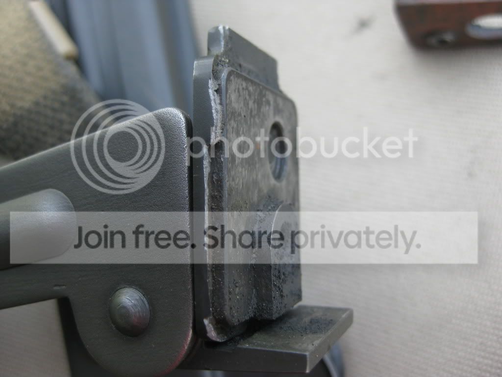

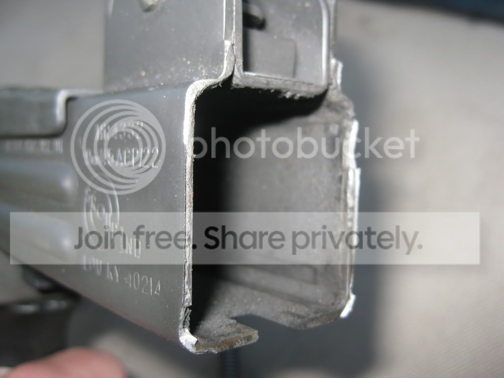

eyegun
Dec 27, 2005
778
Columbia Gorge
A friend of mine blew his back plate out about two years ago while shooting it.
Vector fixed it.
I have lots of pictures but these show the deal.
