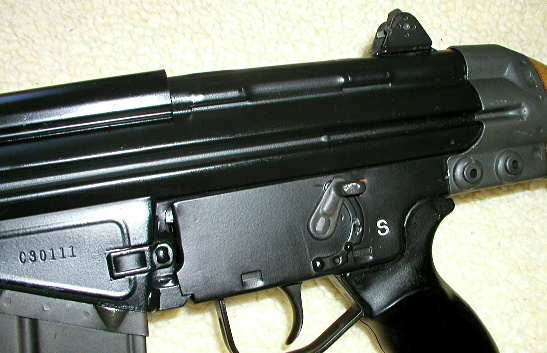

From the research I've done it shows that the gap you see does not equate to the actual head spacing. All the gap is showing is how deep the roller lockers are engaging and is not idicitive of actual head spacing.
That's because a roller-delayed blowback system like these don't actually headspace in the traditional sense. Correct bolt gap is imperative to the proper safety/functioning of such a weapon. If the bolt gap isn't set correctly, the rollers will not engage properly - which can lead to the bolt going out of battery too soon. Worst case is that way too much pressure gets released in a bad way and does nasty things. (Not hugely likely, but still worst case.) The most likely result is that the bolt carrier slams rearward under too much pressure/force and smacks up against the buffer with enough force to jam the rollers out and into the inside of the receiver wall. If that happens often enough it won't be long before the receiver cracks. Here's a photo of my Century CETME that exhibited just such a problem:
You can see the dent in the receiver rail right above the selector lever - there's another one just like it on the other side. The rollers dented the recevier from the inside as a result of the typical drunk monkey gun building that was so common with these CETMEs.
After the propering tinkering this rifle is now running like a top, so I've no reason to expect that a C93 couldn't also be made to run properly... but for anyone who's planning on using one as a host I would seriously recommend making certain the bolt gap is properly set to avoid any sory of badness.
Cheers,
~ Greg ~
That's a timing issue, not a headspacing issue though. The bolt can be headspacing properly and still be out of timing due to the rollers being out of tolerance. That's impressive though, I've never seen a receiver dented like that from the rollers pounding on it.
eyegun
Dec 27, 2005
778
Columbia Gorge
My Vector V93 came to me (from Vector) with bumps like those.
They're really not that big of a deal...
You might see them above the mag also where the bolt hits the round in the mag.
