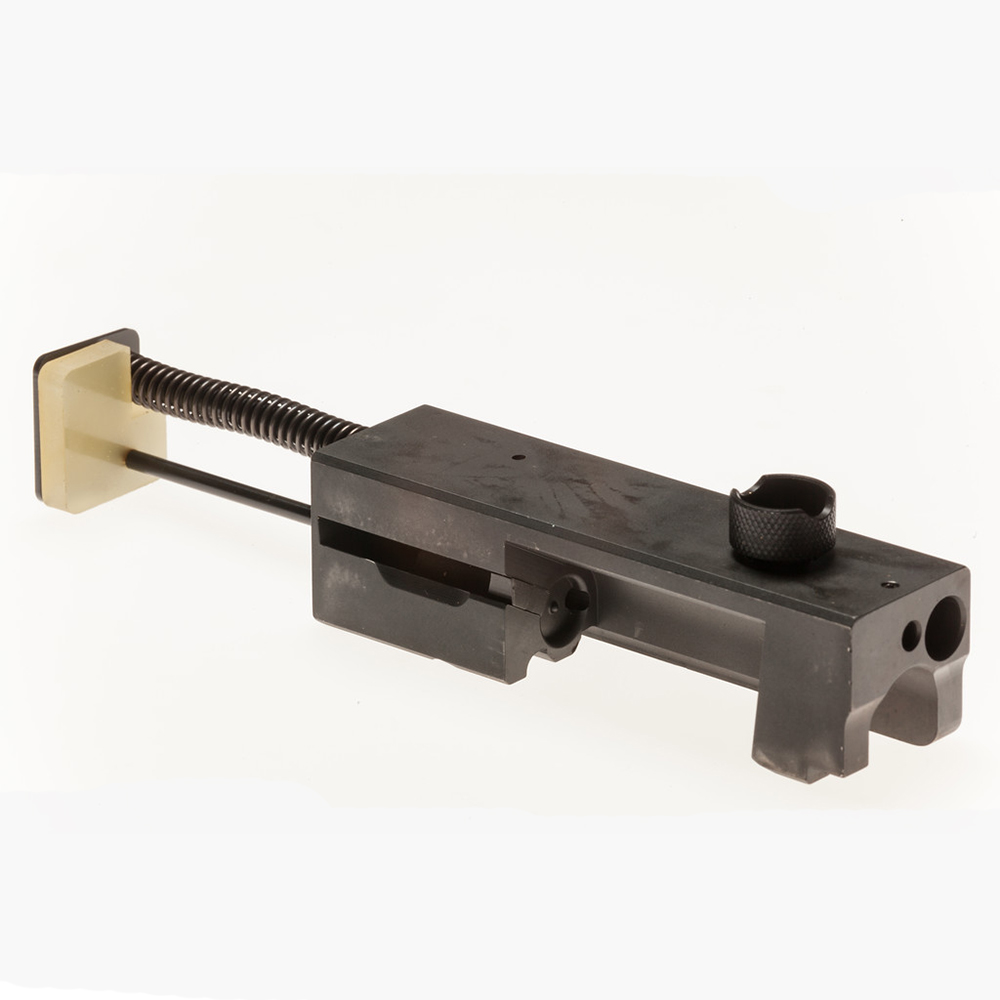

Anyone know the ROF difference between a Cast and CNC M10/9 bolt might be? I know the cast bolt is lighter?

Negligible. Not a precise answer - but the CNC bolt is a bit heavier, blockier, and perhaps runs slightly slower - seemingly for me anyhow. Ammo selection plus suppressor can also affect ROF.

Is it possible for some one to weight there CNC complete bolt assembly please. Thank you.

Thank you for the input but this is for a M10. Just wanting to know the weight difference between a cast and CNC “M10/9” bolt. That’s it. Specifically if someone can weigh there complete CNC bolt. Thank you all in advance.
1,030
Don’t know the weight difference but I can say with confidence that the earlier SWD “slab side” CNC bolt is heavier and slower than the original cast “speed bolts”. In 9mm it’s noticeably slower than the cast bolt, not sure about .45 and also not sure how the modern CNC examples run… this is only in reference to the early SWD CNC bolts that still used the original cast bolt extractor
I found a 4oz weight difference between the original 1973 cast bolt in my M10 and the new CNC one I purchased. ROF difference for my standard 124gr ammo was also noticeable: the CNC bolt in an M10/9 is the slowest near factory configuration, around 1000 rpm.
I’ve since sold my M10/9 or I would have weighed them for you when you first asked: but the difference was at least 4oz when I did.
