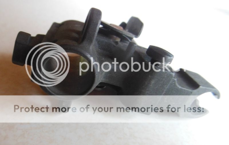

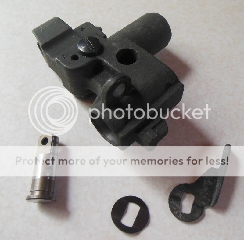

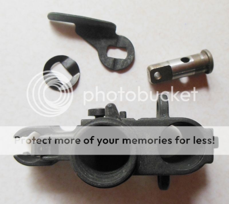

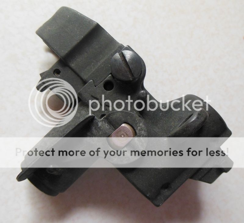

By popular request - photos of what was sold to me as a sniper gas block.
adipose
May 14, 2010
1,188
I'm at work; so I don't have my pictures or sniper rifles with me; but something doesn't look right on that gas block including the missing hole for the front bolt that you use for mounting the hand guard.
Also; if you have a pair of calipers; could you get the dimension of the bore that mounts on the barrel?
I'll take measurements - pictures this weekend and post.

The sniper barrel journal size should be close to .875"
It looks correct to me, virgin no holes New never mounted.
Front hole is for sling.
