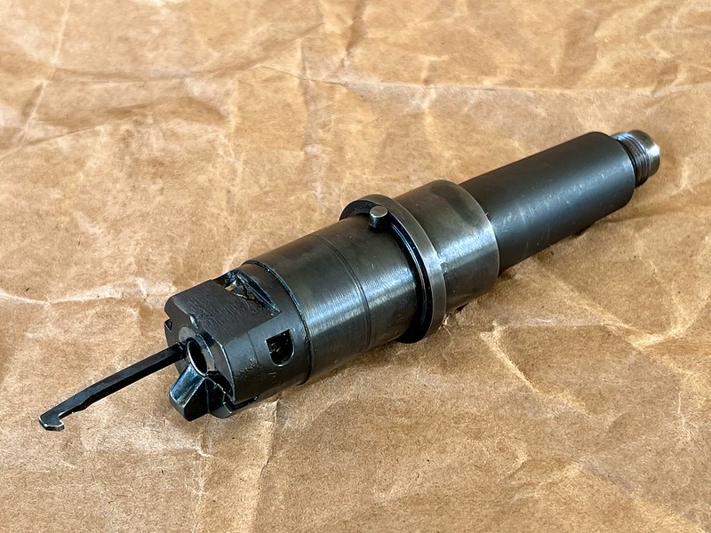

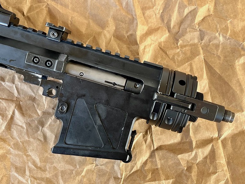

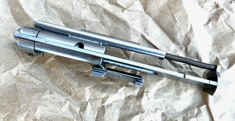

CMMG 22LR is not going to work. There's too many problems with the design. My progress with a S&W 15-22 kit is moving along really well. My gunsmith just finished my 15-22 to AR15 design barrel nut. Deerhurst's prototype clips work really well for the 15-22 mags. It feeds like a dream. I hope to be testing in 2 weeks. I will need to make a sear catch and convert to an open bolt protrusion.
EDIT:
I was wrong. The CMMG open bolt does work with a few mods. Much easier and cheaper to convert than the S&W 15-22 parts.

Really cool. Can’t wait to see a video.
Is the ejector welded on?
