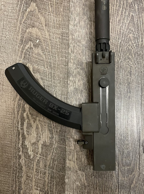

I have been tinkering with this little .22 upper for my M11/9 and I feel like I’m finally getting an acceptable level of function with the right combination of a proper RamLine magazine and it’s preferred ammo plus a suppressor. The problem I’m running into is that my AB Little Bird is the only can I have that the first baffle is far enough forward to clear the length of muzzle that extends beyond the threads and the AB is really not built for FA use. I bought a Hughes Precision barrel extension to try but it bottoms out on the muzzle before it threads all the way on.
So my question is this: those of you who have a Fleming kit, what suppressor are you using that clears the goofy anteater barrel? Are you using an adapter? The thought has crossed my mind to simply pull the barrel and cut it down and recrown it at the end of the threads but I’d rather leave it original if possible. I’m currently leaning toward boring out the Hughes extension enough to clear the muzzle and hoping for concentricity.

I had the same situation with my M11-380 and the Fleming .22LR upper. What I did (but I only did as a tryout since my .22 silencer isn't full auto rated) was to install two of the nut like spacers that are specifically designed and specially manufactured to exact tolerances for such instances. IIRC, SilencerCo and Tactical Innovations and maybe others have sold them. That got the silencer far enough out so it could be installed and still left enough threads engaged for secure, concentric installation. Not the most pretty, but it seemed to work for my silencer, but might not work for yours.
Instead of a silencer, I ended up putting a long extension on the barrel to get the muzzle end far enough away from my support hand for safety and comfortable, controllable handling. And the upper works with high power .22LR ammo such as CCI MiniMags, so no "silencer boost" is needed.

I’ve got a Fleming M10-22 kit.
I just screwed on my Spectre II can and it work great.
Edit, here’s mine with the 22 can
1,147
I use an AAC Element which is full auto rated. But mine is from the old AAC company. The new company has a 'Gen 3' version out that is also good for full auto (and 5.7x28 interestingly). but I don't know if it's the same at the entrance.

I use a OG Spectre by SWR on my flemming upper.
Works great no issues with direct thread mounting.
It is FA rated.
Someone had one for sale in the NFA section a bit ago not sure it is still for sale.
They are tanks Henry used to make vids shooting 556 through them.
Only down side is after 500 rnds or so you need the pusher tool to get them apart.

I appreciate all of the replies! I decided to go ahead and bore out the Hughes Precision adapter just enough to clear the muzzle. The way I figured it, worst case scenario is I’m out $28 if it didn’t work or if it had alignment issues. I picked a bit that was slightly larger than the extended muzzle but didn’t contact the female threads and flagged it just beyond the depth I needed to clear the muzzle. It cut nicely and the female threads remained clean. It threaded on nicely and passed the alignment check. I went out and dumped 20 rounds and I’m pleased with how it sounds. Next up is the improved extractor and getting my hands on a few more Ram-Line mags.

You can modify a Ruger BX-25 mag to work. I did it and it was kind a slow process with a hand file. It works okay with it but I still need to make some adjust to the Ruger mag.
I’d try some of the older butler creek mags (the ones with the metal feedlips). Not the hot lips ones. They still might make them.

I bought a pair of the BX-25s as well as an old Doc Bannick BX copycat and have fitted them to clear the bolt but they still struggle. They don’t lock in as well as the Ram-Line and I noticed the ejector face is located further back. I think that contributes to the poor ejection performance compared to the RL. I haven’t given up on them and I plan to continue tinkering with them but I’d like a few more RLs to have on hand in the meantime. The Fleming is a giggle machine when it’s running well but it gets frustrating when it decides it’s hungry for empty brass.

On the subject of "10/22" mags in the Fleming .22 uppers, my experience: two,10 round Ruger BX mags worked out of the package; one 15 round BX was good to go new, and a second one and three 25 round BXs needed to have the front and back of the bolt channel filed down quite a bit; three Champion 25 round stick mags only required minor front and back of the bolt channel filing.
A ProMag 55 round 10/22 pattern drum only required minor front and back of the bolt channel filing for bolt clearance, but had to have graphite powder added during loading; and the spring tension is so high that after firing the first round, on the stroke rearward the bolt could not overcome the drag from the next round pushing up on the bolt, so the bolt stops part way back. I have an AR pattern feed tower, 50 round BDM mag and it also exhibits a high spring force on the ammo, so I haven't bought a 10/22 feed tower based on the ProMag drum experience.
CCI MiniMag 40 gr., round nose, copper coated ammo has been the most reliable ammo that I've tried.
I have a couple other firearms that use 10/22 pattern mags and mags that worked or didn't work in the Fleming upper work in them, so my 10/22 pattern mag count for range trips can be consolidated.

As far as magazines I have tried, the Ruger brand mags in all have been somewhat disappointing. They are very tight in the mag well, most require fitting to the bolt, and have been lackluster in ejection performance. The 10rd mags from various 10/22s I have lying around will lock in but are very difficult to remove. I have only actually fired one of them. The Doc Bannick mag struggled with both feeding and ejection. I also tried a 30rd plastic lipped Butler Creek and a 32rd ProMag that both required no modification to fit but neither would eject. The Ram-Line 30rd is the only one that usually doesn’t have issues.
As to ammo, round nose Mini Mags have worked well while the hollow points jam on the barrel. The CCI subsonic HPs have done ok. I’ve actually had the best luck with Fiocchi plated RN 1240fps.
