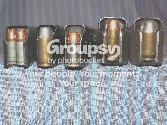

salvo said:
PM'd Barrelxchange yesterday about the conversion, no reply yet. From what I can tell I need a barrel, 45 acp bolt w/ 9mm extractor, grease gun lower and M3 mags....right?
Correct
Has anyone done this conversion?
I run 40 S&W,,,,, 45 bolt, 9mm extractor, 45 lower, 40 barrel.... swap barrel to 45, install mag of 45acp, and shoot 45acp.
Anything else needed, other than ammo?
See previous 2 answers above
Do the M3 mags work without any modification with 10mm?
You need to close the lips slightly to retain the smaller case of the 40/10mm, but the mag can still be used for 45acp, that is how I do it.
How about heavy recoil springs?
Run what you brung.. recoil on 10mm is lighter than 45acp.
I would guess 40 S&W and 45 ACP would only need the barrels?
Refer to answers above
Thanks
Here is pic of a 10mm in the M3 mag, and a 45acp in the M3 mag --
