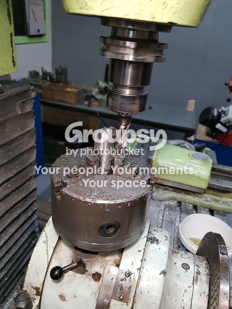

Decision was to freefloat barrel and add permament optics rail for ACOG. That's why we"ve took our AK freefloat kit and jeopardized it a bit.
Heart of the system - new gastube:
Modding AK chassis barrel nut to fit new gastube and Galil reciever:
Testfit:
So project after barrelnut fitted to the reciever and married to the gastube:
Problems so far

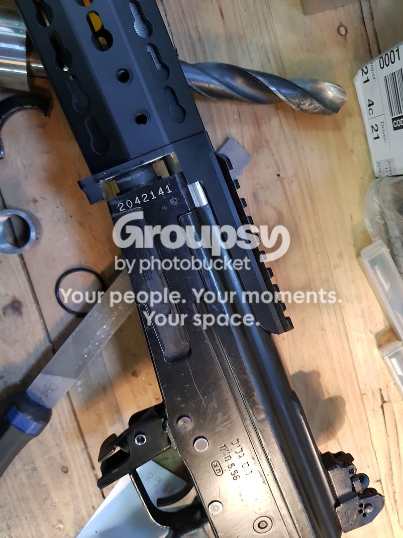

1. Foreend is long. And gasblock is a brick.
Guys do want to leave frontsight at place.

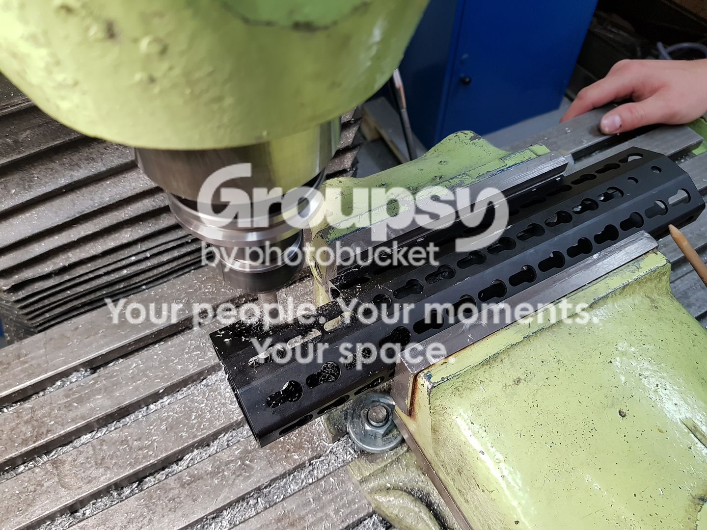

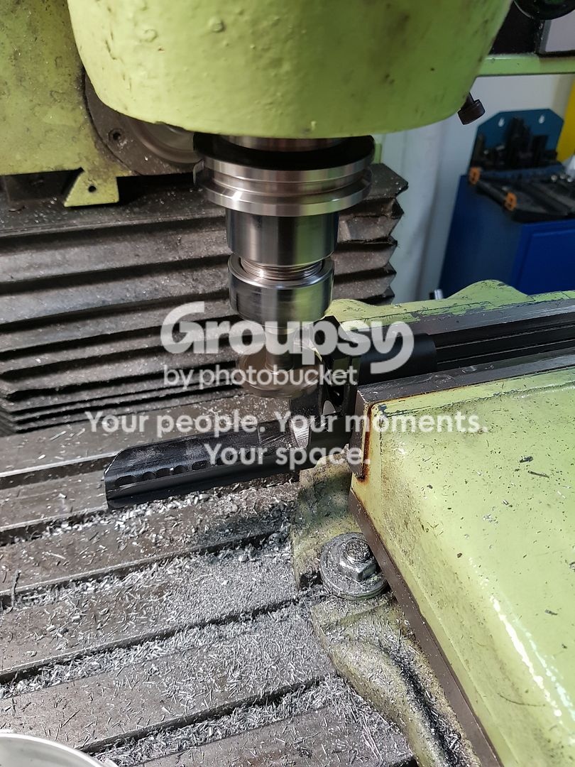

Solution - either shorter foreend or cut the hole in long foreend.
Decided to go with cutout in long foreend:

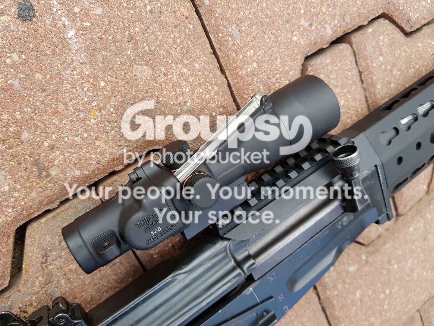

Problem number 2 - vertical charging handle.interfere with any picatinny claw. But don't interfere with ACOG mounted directly. Solutions: either move picatinny UP or just use (as for now) ACOG prism direct mount.

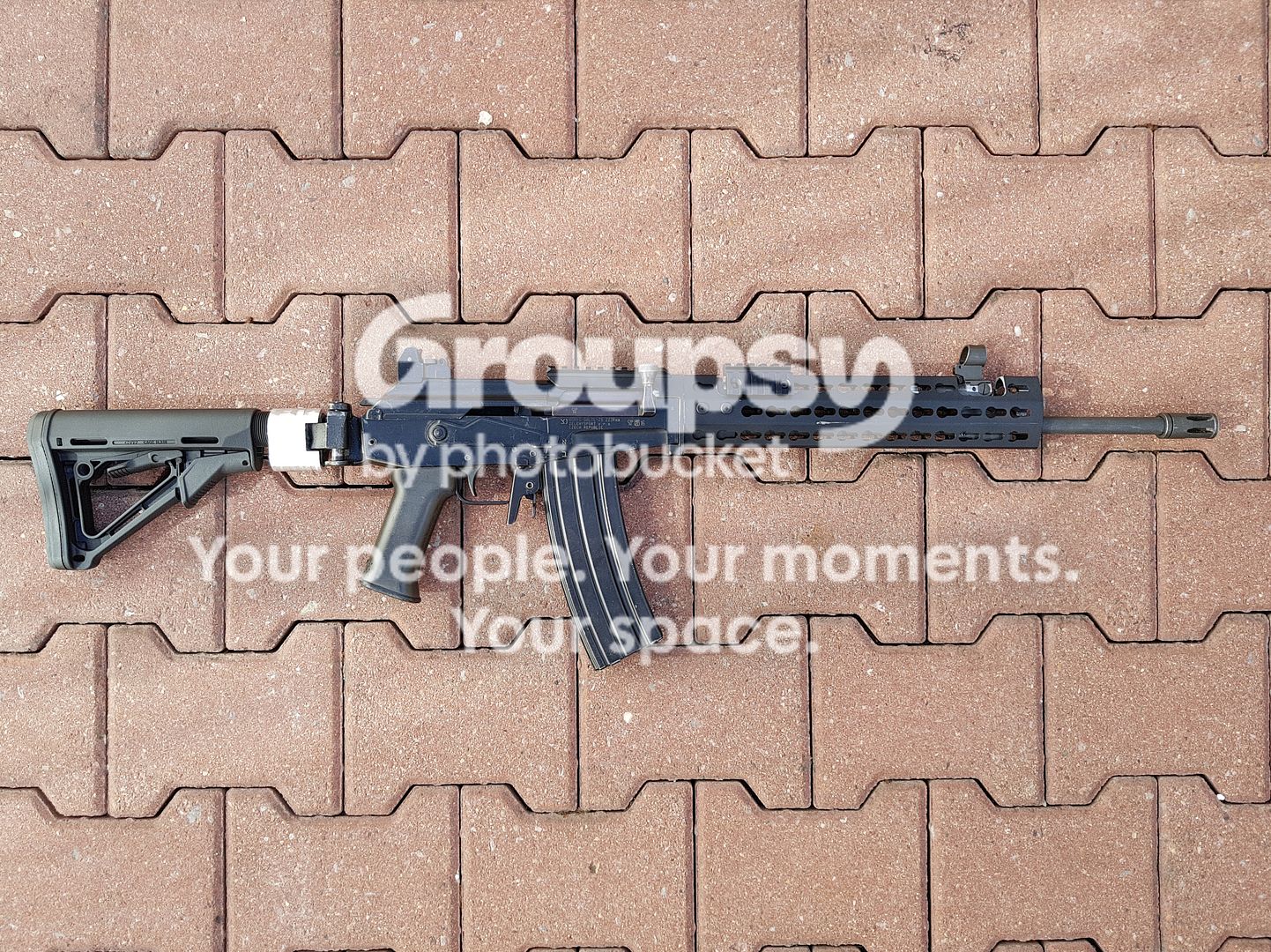

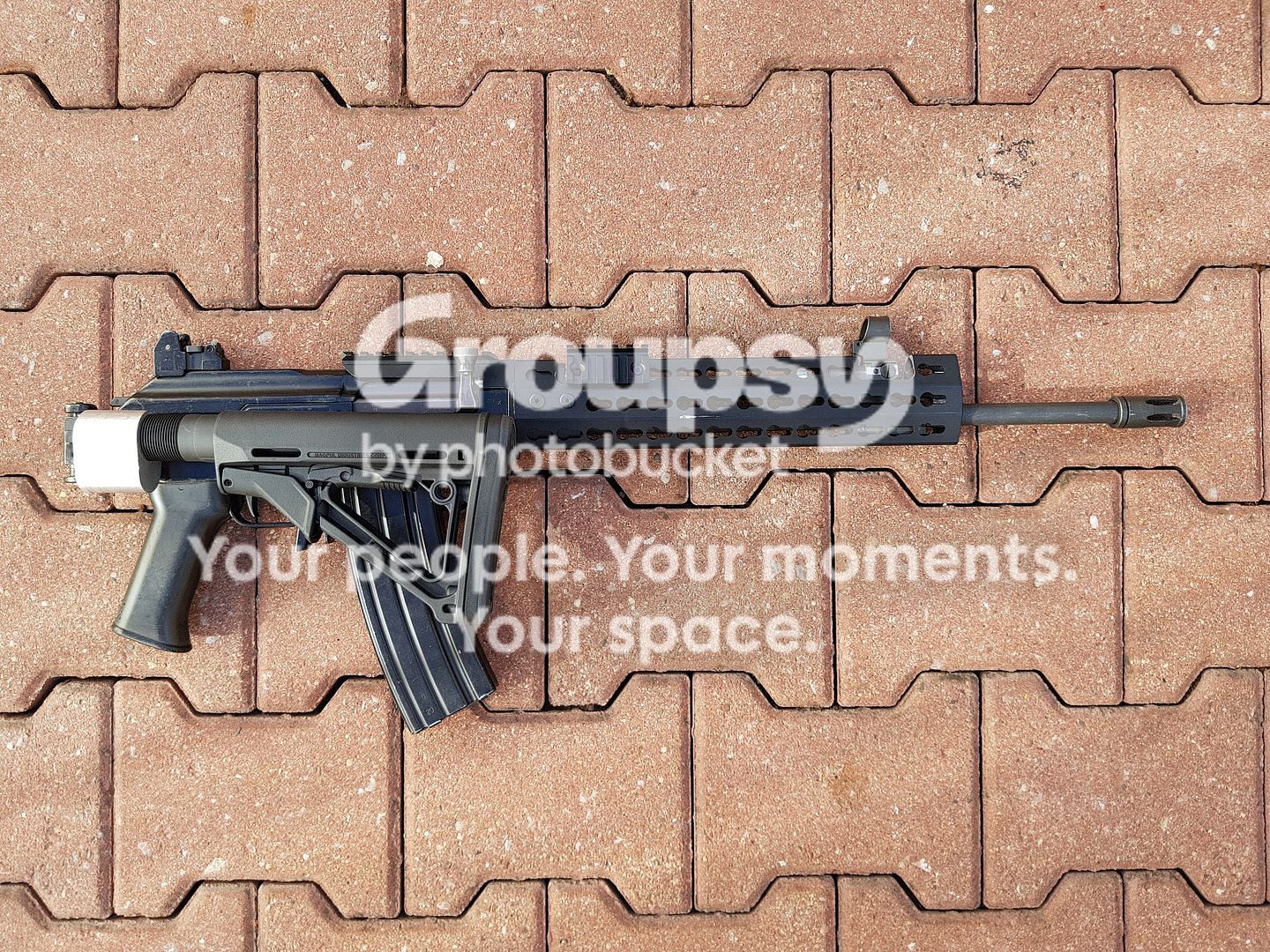

Well since the original gun is intact and alway can be converted to the original state i don't see any issues with takin it as a donor.
Meanwhile this build was completed. Just added an AR tube adapter so guy can use his beloved CTR.

Hi vtb
That looks nice!
What manufacturer free float did you start with?

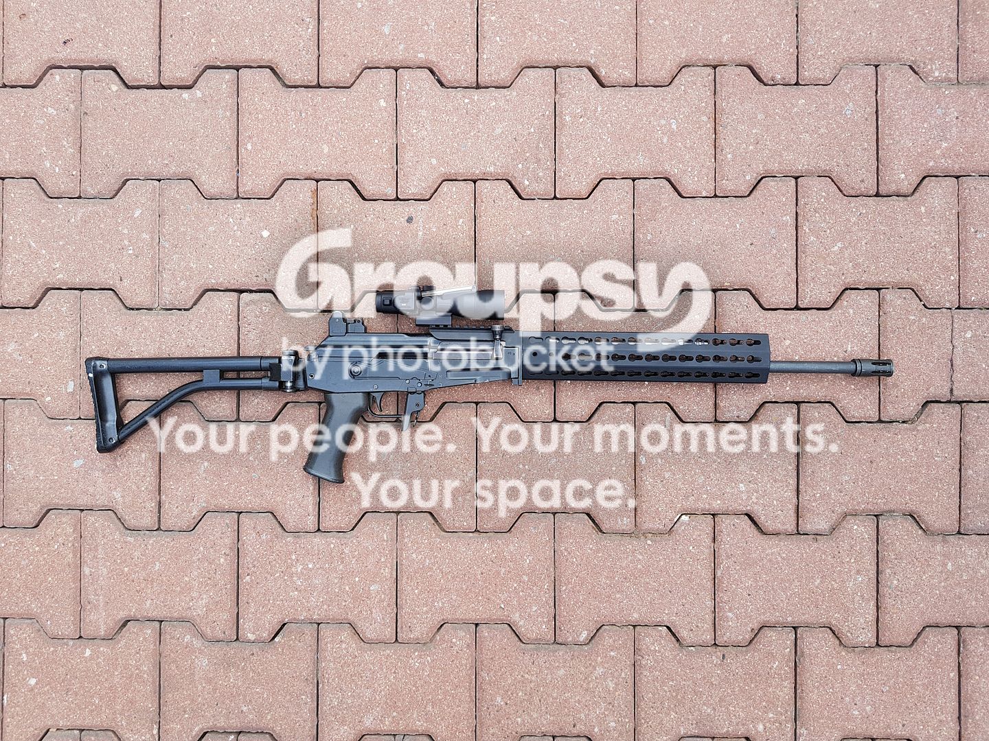

I like it. I used a modified B&T Sako RK95 rail years ago on a Galil switch barrel build but that handguard was expensive and heavy. Hope this one is neither.
