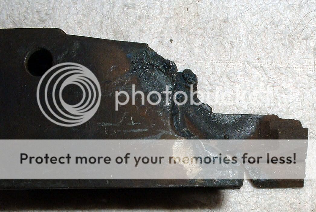

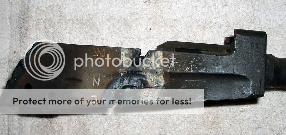

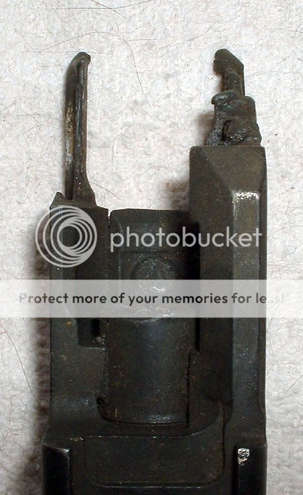

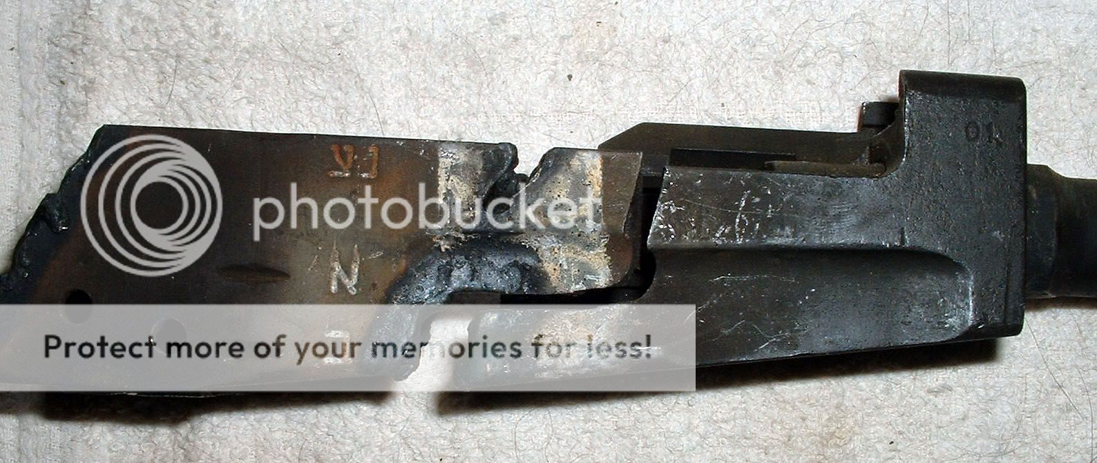

I reciever a cracked Galil reciever [demilled] from Sarco. It was cracked right at the back of the locking lug recess on the right side. You can see where the torch cut for the demill wes going down the side and when it reached the crack the reciever just fell apart.
i do however, when i eventually get my hands on a 308 galil, plan on purchasing a simple buffertech galil buffer which im SURE will prevent any problems with the rear of the reciever taking alot of abuse
Some interesting notes on the 308 Galil. The reciever is the same as the 556 except the mag opening has been lengthened foreward for the longer mag. The bolt carriers and recoil spring are the same. The 308 bolt is the same as the 556 bolt except the face has been opened up for the larger cartridge. A 308 bolt will fit in a 556 carrier and actually lock into the 556 locking lugs. The locking lugs are the same size on both the 556 and 308 guns. I'm not too worried about my 556 cracking but the fact that the locking area is the same on both guns does make me uneasy about the 308.

It was most likely driven over by a tank or something like that.. look at the pitting one the receiver.. I have two very used ex military sar that show no signs of anything like that..
