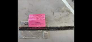

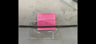

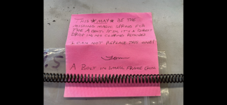

While looking for a new spring to begin with, we stumbled upon this relic of the past from Vegas SMG. A hand written note to my friend during the early A-bolt days.
Thought you guys would want to see. I can almost hear him saying the words.
Here’s an unmodified orange spring on top for reference
Closeup

^ to get the sound I wanted we cut probably 1/3 off a new spring. When placed onto the recoil rod the spring extended roughly an inch past the end of the rod. Quite short, gun sounds pretty good and controllable (torso accurate, need practice for a softball size target). Sorry no videos, next time.
And Tom’s note with spring was put up separate from all others to be kept as a momento.
