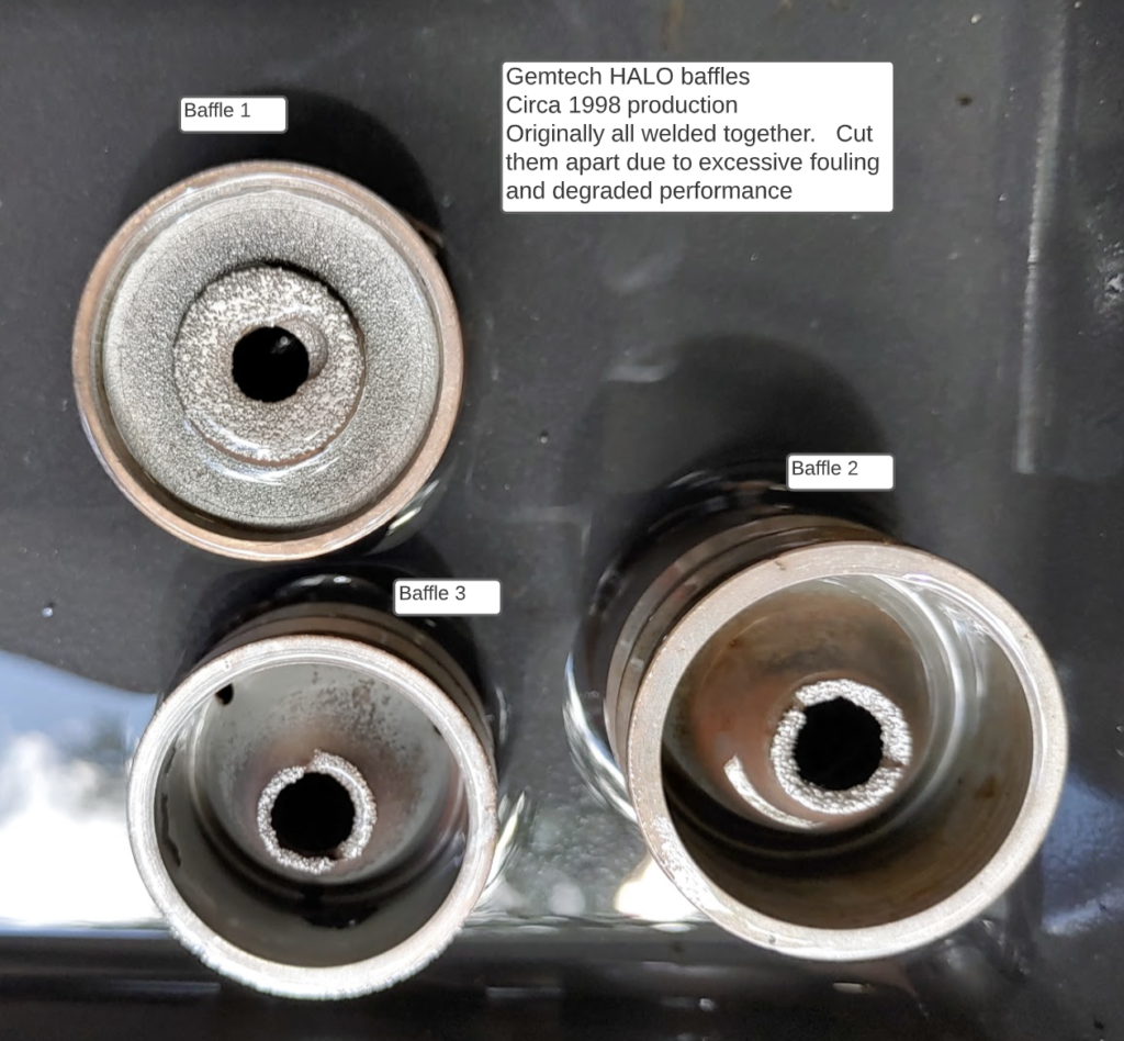

Gemtech HALO.
Speaking of the HALO, I've had one since 1998. I never really ran it that hard but for a short time I did run a full auto Norrell 10/22 on it and clogged it up..
BTW, the idea of dumping full auto 556 through it to 'clean out' 22LR doesn't work... I finally broke down and sent it to Curtis Tactical to have them jail break it and part the baffles. I know orientation is important with this design but I don't plan on using 556 on it anymore.
Here is a picture I took of the baffles after they have been cleaned up and soaked in silicone oil to prevent build up.

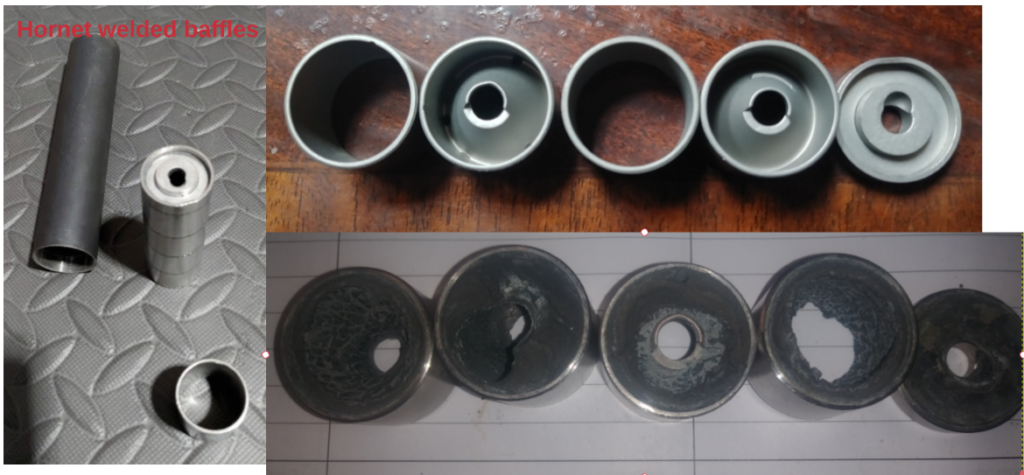

Totally agree....and for 22LR must be serviceable. Back in the early 2000s most manufacturers didnt want to sell serviceable cans.
I was hesitant to buy the Gemtech Hornet pictured below. Dr Dater did not seal one side for me so I could remove the laser welded stack but I still couldn't properly clean it.
Note that this can was advertised to take full auto fire from an AM180 and was even pictured mounted on an AM180 in their catalog.
Well you can see how fouled mine got...to the point it was loud and so I had Curtis Tactical part the baffles for me and clean it.
I also asked Gemtech before they were bought out by SW about servicing it and they told me they couldn't do anything for me.
