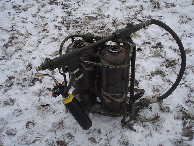

what cu ft is your tank and did you have it hydrostatically tested before building? do you plan on during a hydro every 5 years same as in scuba diving? how much pressure do you use in discharge tank? is it CO2 same as paintball?
It uses a 20 LB CO2 tank. It holds 3.5 gals of liquid. The CO2 tanks are rated at 2.5x the pressure it uses. I have no plans to have it hydo tested. I do have plans to change the lines if they start to degrade. It's uses paintball CO2 tanks that are regulated to 350 psi.

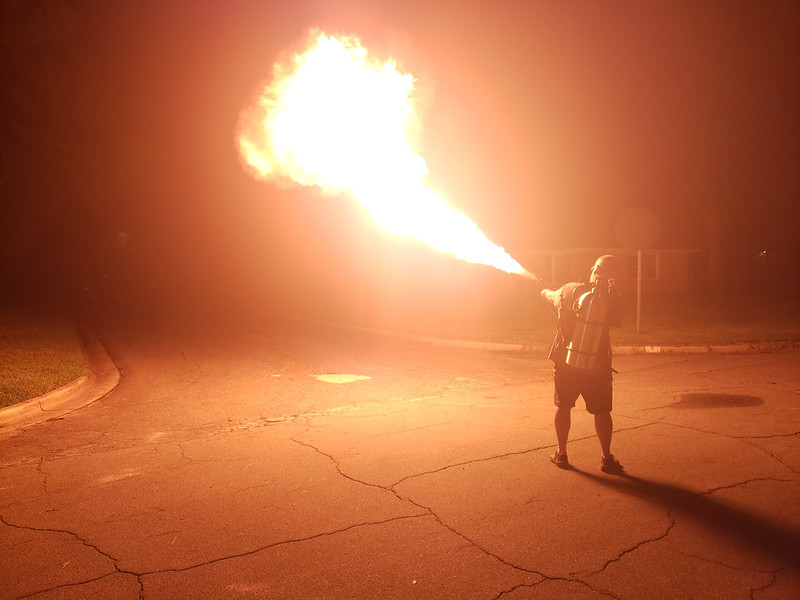

In that photograph, I'm using straight gasoline because it's being shot in the street in front of my house. I didn't want the flame to go too far. Straight gasoline makes a large fireball. If I mix soap, kerosene or diesel with the gas, it will reach about 45 feet.
Before i made mine I had training with an expert. I learned and shot a few of the historical examples.
