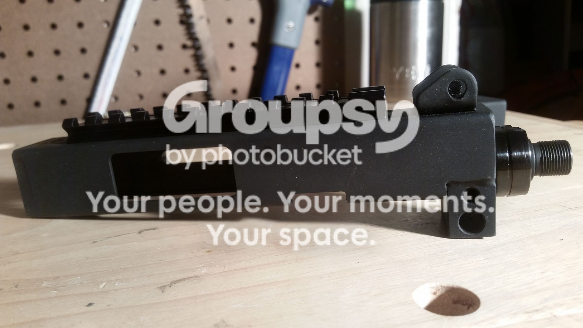

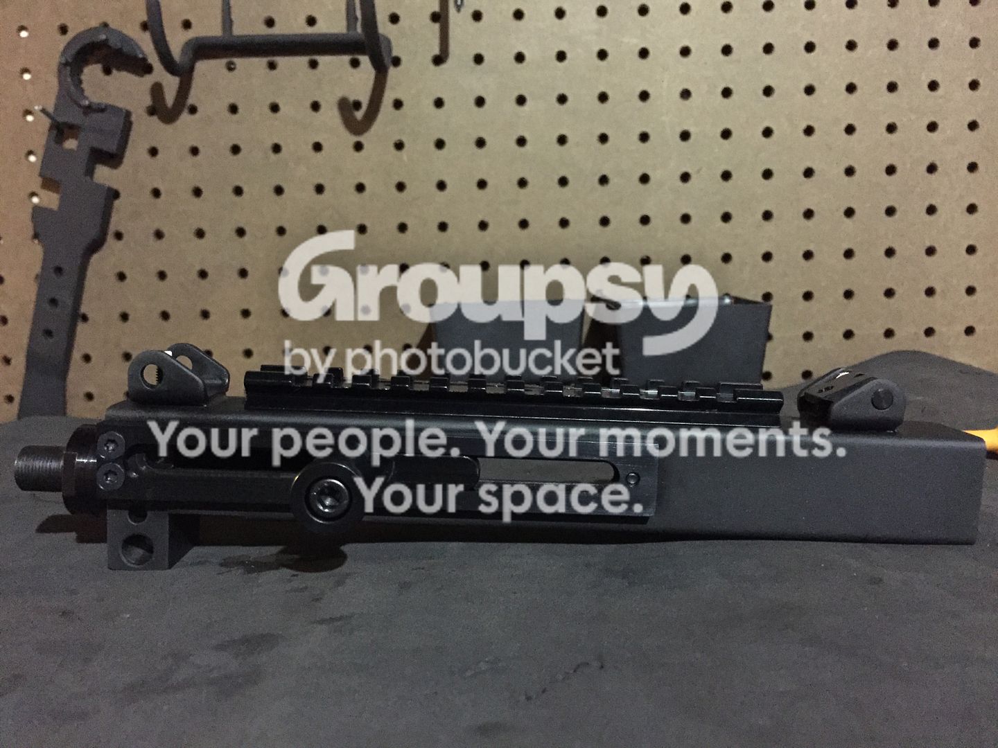

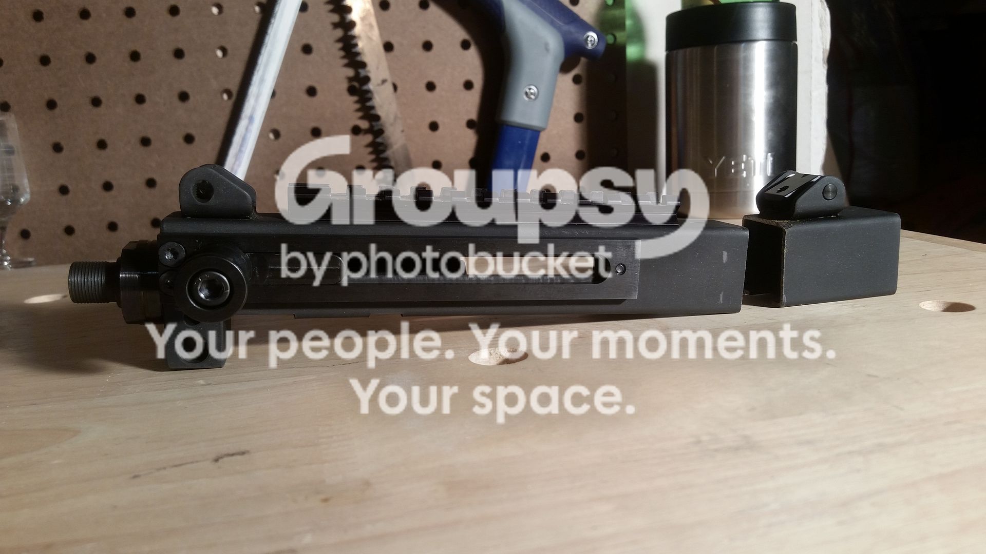

Check out my patent pending .380 weight loss program!
Before:
After!
hehe
Everybody was saying their .380 lengths were about 6.8", I went long on the cut because I noticed the Lage Max-11a1 mk2 was longer than that on the lower part. Cut the rear large picatinny section off as well up to the next set of ears. Hoping I don't have to alter the cocking knob guide. When I get back home this weekend I'll get to test fit. Strobro send me an address to send this new sighted paperweight to!
UPDATE: 9/30/2016
6.8" is the right length for cutting. My cut was too long the first time and I'm going to have to grind it down to 6.8". You also have to grind or cut the lower edge of the cocking guide.

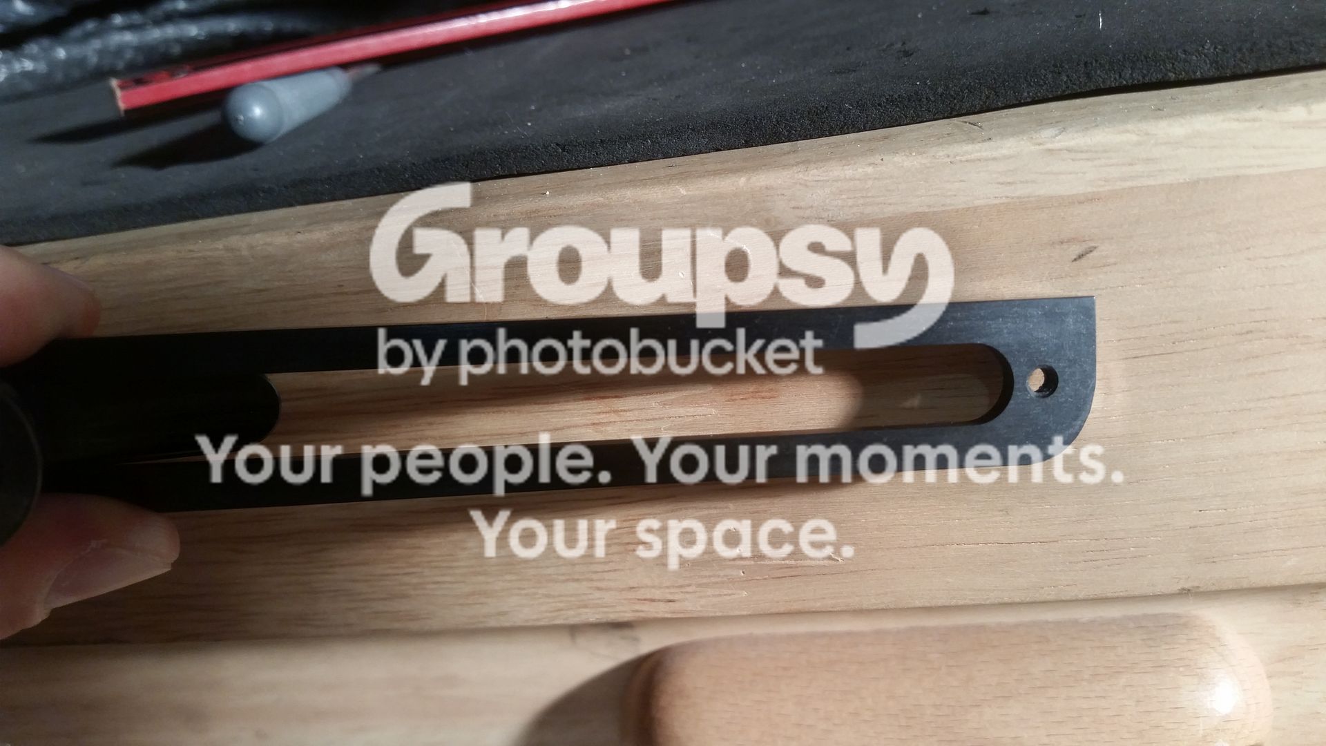

and the other side
