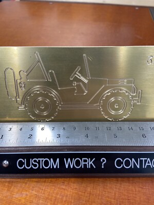

Search NEW HERMES PANTOGRAPH on ebay there is a guy that does custom templates for the above mentioned panto engravers.
I have made my own templates by hand so I've never used him.

Here is the guy that does custom work. Contact info is in the 2nd pic of the ad.
Also just search for NEW HERMES I'm seeing the machines from 100.00 to the sky is the limit.
