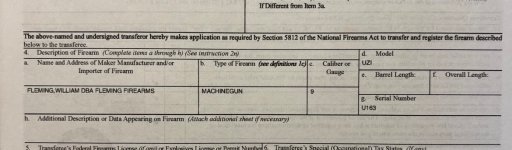

I have bought a few Uzis and there’s a Fleming sear mini uzi in the pile. I don’t think I want to keep it. The gun is exactly one serial number and the sear is exactly one serial number behind this one that sold in one day:
Mine has a barrel xchange heavy bolt (as well as the original bolt) plus a frontline leather shoulder holster.
Given that two years have passed since that sale, and the extras mine has , am I off in thinking $35,500 delivered is fair?

There’s no mention of the host on the form 4. It’s exactly like the listing i linked.
Both bolts have feet. So it appears to be one of the 10 or so that Fleming made before atf stopped that practice.

Yes, on these Fleming registered sear guns, the sear is married to the bolt and receiver. That's why they are all marked.
Such a weird way to convert it. Why not just register the receiver since the sear can’t be moved? Is this inferior to a regular RR mini then?

My understanding is the sears were registered before the guns were even imported. The import started after the hughes act. Fleming was then adding the sear to the newly imported gun. But in effect he was creating machine gun receivers by clearancing the trunnion for the full auto bolt feet. Atf frowned on this and forced him to stop.

How the atf would know the difference, i don’t know ??
But even if you remove the sear from this host, its still interpreted as a mg (I believe)
So if the sear gets obliterated ( I know that will never happen) you will have a 30k paperweight! IMHO

There was a limited time window from when Hughes was signed and it went into effect. SOT manufacturers were papering everything they could to have future inventory they could sell.
Some of the more known cases was a manufacturer drilled the sear hole on a pile of AR-15 receivers but didn't have time to machine them internally. ATF denied the registration because they weren't totally converted but also declared they were MGs because of the hole. The American 180 folks registered a bunch of receivers that didn't exist yet, and got caught using an unlicensed local machine shop to crank them out later. Some just had piles of Form 2s and nothing else they would build on as needed. IIRC, at least one was selling them to people who "found" an existing MG and used the form to register it.
Others registered "conversion parts", such as OEM sears. ATF wasn't nearly as particular back then and a few SOTs installed their conversion parts by modifying guns to FA spec, in effect creating a registered receiver conversion but using the sear as the registered part instead of the receiver as they should have. After a few years ATF caught on and stopped the practice, but allowing the already completed ones to remain as a married combo.
Specific to the mini, a FA bolt can be made without the "feet" but requires mag insertion on a closed bolt and may not be very reliable. Those do not require receiver mods and in that limited case the sear can be swapped between guns.

+1, read the Mini part of the conversion article: https://uzitalk.com/reference/pages/FAconversions_mini.htm
I wrote the original iteration of the conversion pages in the library.
I also spoke to Fleming on the phone about these after I got my Fleming Mini Sear gun. I love mine.
What I think is strange about the listing on Sturm is that it is a semi sear. I have a SMG sear. I also have a friend that has a Fleming Mini sear gun also which is 1 digit off from mine as well and his also a SMG sear.

Just checked my paperwork. Mine didn't show married either.
