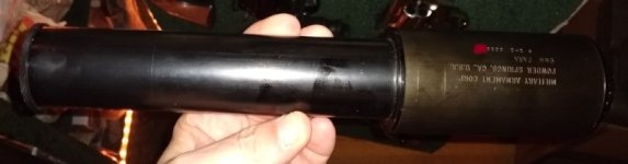

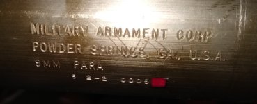

Can someone tell me what sort of suppressor this is? Was it designed for the M10 originally? I thought it was a SIONICS but is has a different end cap than what I was expecting (one with the two holes on opposite sides). The markings are also in a different location that what I have seen before. It has on the side of it engraved:
Military Armament Corp.
Powder Springs GA USA
9MM PARA
S 2-2 005xx
I am guessing this means it was in the first batch of 500 in that series but not sure what the s 2-2 preceding it means. I also cannot get the end cap to loosen no matter what I do. It has probably been stuck for the last 40+ years however. If anyone has any suggestions please let me know. Does the mid section unscrew also and have the shoelace inserts in it? I don't hear anything rattling around inside when I shake it. The first stage is also a slightly different color than the second stage.
Thanks for any info you can provide.....

The endcaps sometimes had locktite applied on the threads. You might try soaking it in very hot water. The larger portion does unscrew, there should be shoestring eyelets inside, they are packed VERY tight, they don't rattle. Its hard to get them all back in, once removed. Cut-away suppressor photo on Page 128 of MM shows internals. In the MAC Man book on pages 127-128, shows several Powder Springs, GA suppressors, all have the markings stamped vertically, opposite of yours. RPB and SWD sold LOTS of no-paperwork, unmarked tubes and internals for DIY guys. That is why it is now illegal to posess suppressor parts.
Who is listed on the form as the manufacturer? I have seen aftermarket tubes marked Powder Springs by the builder to increase its value.
"not sure what the s 2-2 preceding it means"
The first 2 is the caliber 9mm, .45 were 1-, .380 3-. the second 2 is the year made 1972

Now there are some interesting markings. What does the F4 say about manufacturer? Is the rear tube aluminum or steel? P.S should be aluminum.
Getting the rear stage open is difficult. I have used strap wrenches with strips of an old inner tube for disassembly. The end cap should only be hand tight. There is a tool with the 2 pins that will help.

Here's one from a Sturmgewehr ad a couple of years age, the same markings and less than 100 serial numbers away - with the matching M10:
http://www.sturmgewehr.com/forums/index.php?/topic/6851-sold-transferrable-powder-springs-m109mm-matching-sionics-suppressor-7500/
This one is pre-spanner holes, after 47 years the the wipe has probably become one with the endcap. Soaking in Kroil cant hurt, but it's going to be a mess inside if you get it apart.
Good research. So it's confirmed that it is an early Ingram suppressor. Nice score. I would like to see more pics of the end cap and what ever components you find inside.

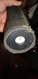

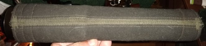

I am curious about the nomex cover for this. Do all these covers have the wide stitching at the bottom as seen in the pictures?
I also noticed that the wipe on the end cap has turned into some sort of greenish color. I am going to soak this entire end in some PB Blaster to see if that will loosen the carbon / crud built up in it so I can unscrew it. Thanks to all who posted info / suggestions...

The Nomex covers were a tight fit and difficult to install when new. But I never had one tear. That wide stitch looks like it might be a repair. I do not know which covers are original pre-auction or later RPB, ect. That wipe in pic looks rotten. The endcap wipes were not made to be replacable. You would replace the entire endcap assembly. They cost $15 and were legal to buy back in the 70's. Now you can modify the endcap to allow replacing the wipes.
Some pics of covers show the stitching basically the same with minor variations. The bottom cover is the from the 70's. The top cover is 80-90's.

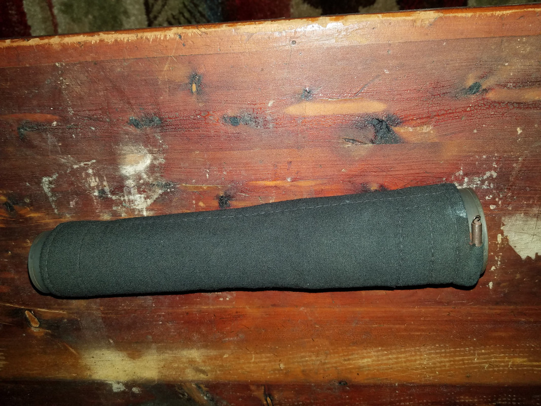

here is a pic of my cover from the other thread, I just got it complete with fake can for $25 at a local gunshow

That stitching is what my cover looks like too, and I bought mine from the original owner. Gun, can and cover have been together since day one, and can is s/n matched to gun, so I would assume that’s an original Powder Springs or sionics cover

Are both ends of your can aluminum? There are some interesting variations on these it seems. Some are all aluminum or a steel / aluminum hybrid. Does your cover fit very tighly? Mine slips over somewhat easily but is not loose by any means. What exactly is the purpose of the spring on the large end of the cover? Is it supposed to keep it more securely attached?
