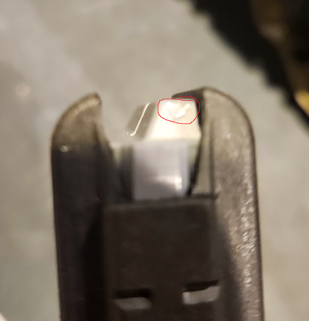

I just received my lage 10/15 last week and was making sure it functioned correctly when I noticed that the bolt would get stuck on the follower on the last round. I tested multiple brand new pmag gen 2, gen 3, and some extra troy magazines laying around and they all had the same issue. I attached a photo below to show where the bolt is hitting on brand new mag for reference. It seems pretty far off from being able to clear. I am pretty sure this is probably not normal function but just wanted to check other people's experiences, specifically with pmags.

Because there is no last round bolt hold open like an AR 15, the bolt will hit the follower and should push it down. Try to use a magazine that has a follower with a ramp on the back. Regardless if the bolt catches on the follower on an empty mag’, the upper will function just fine.

Thanks for the reply, any recommendations on mags that already have the follower ramp? When releasing the bolt from the rear most position it unfortunately still does not have enough force to ride over the follower and instead takes a chunk out of then plastic like the picture in the previous post. This probably isn't idea for long term usage and while I was hoping to reuse the 100 ar mags laying around, I don't mind ro buy specific mags for this upper. I was nervous that it was a sign that something else is off as well with the 10/15 upper and wanted to double check before I fire it the first time.

If you are dry fire testing these mag’s, make sure you insert the mag’ and then tug down on it to make sure it is not over inserted.

just rechecked with multiple brand new gen 2 and 3 pmags again making sure I pull down and it still completely hangs on a dry fire. the bolt does not look like it is even close to clearing. I have tried dry firing on one of my new pmags maybe 10-15 times and it has taken a decent chunk of plastic out of the follower when it hits so there is no way this will would work long-term with pmags (or the troy and hexmags i have on hand). Would you be willing to take this back and check it out to make sure something isn't out of spec? If so I'll give Jackie a call and get it set up.

Simple fix as I did this to all my P-Mags. After a dry fire and the bolt mark is left on the follower,remove the follower and use a file or piece of sand paper to round/angle the follower where the mark is.You may have to reassemble and dry fire a couple times till you get the follower where the bolt will push it down and glide home. This is an easy fix if you have a little mechanical ability. You will basically make a small left angled ramp where the bolt mark is. Easy Peasy.

Interesting thread. I've only used older 20 rd USGI mags with no issues. And as I look at them the back of the follower is rounded/sloped. I've also looked at all the various flavors of GI metal bodied mags I have and all have the same rounded follower. The mags I have that don't have a GI contract number on the package have the squared follower. You can probably get a small rounded bit in a dremel and slope the followers in place without removing them from the mags. Or just get mags with the sloped follower, there are plenty out there.

Filing down the pmag is probably the way to go, although i will probably just take other's recommendations and buy a bunch of mags that already have the ramp for the bolt in the rear.
