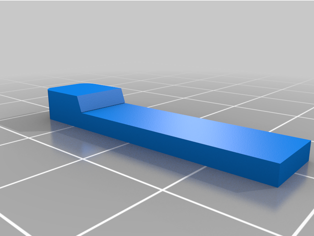

I prefer the stem magazines. I file them and hammer a little to get them to fit in the mag well. Then I 3d printed a Suomi tab for the back. My original 3d printed tab is still going but then I cast some out of zinc. I bolt them on then jb weld around them.
If you want them to be reliable update the springs that helps a lot but also more importantly be sure the bullets present at the right angle 7 degrees. If not adjust the feedlips.
