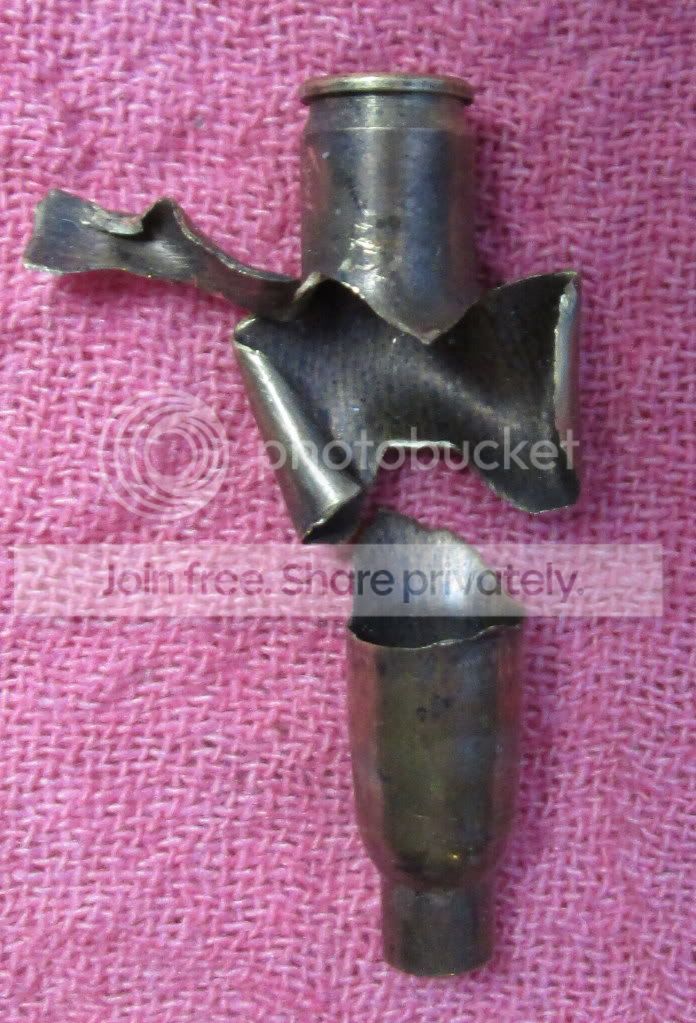

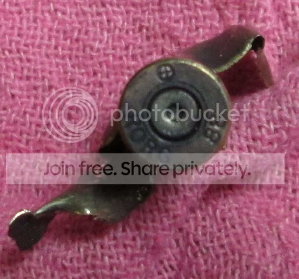

Sounds like time to check what would be called "timing" in an Browning Machine Gun (i.e. 1919A4), don't know if it exactly applys to the "HK"23e but on the G3s when they were first setup with a sear pack always placed a spacer in front of the bolt (drill but) and make sure did not fire with the bolt a little bit open.
eyegun
Dec 27, 2005
778
Columbia Gorge
There's been quite a bit of discussion on the possibility (or not) of an OOB using the roller locked/locking piece/HK mechanism. Then you see a couple of pics like this with a solid primer hit and the case is blown apart and you have to wonder....
