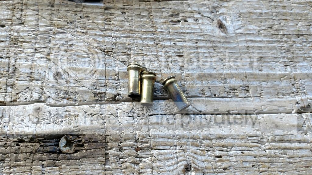

I have a question for all the 22 kit gurus. I have blown out two extractors recently and also encountered some OOB's, most of my spent cases look like this:

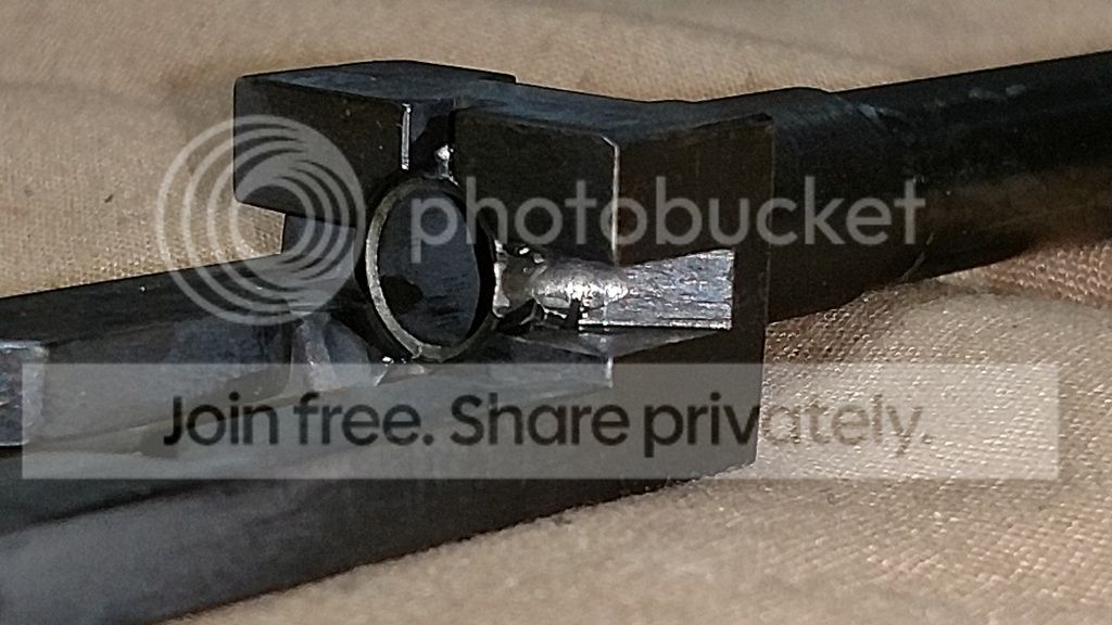

The barrel liner section looks like this after cleaning.
Those dark spots are actually holes that a pick can go into. Are those holes supposed to be there? I have cleaned the chamber with a .270 brush to remove any lead build up and will try again next range trip. Any other advice would be appreciated. Thanks.

Wow ugly brass there.. I don't know that holes would cause that- take some 22 snap caps and manually cycle them through to see if they fully seat in the chamber properly. Is the rifling at the head of the chamber clear & clean? Does this happen with more than one type of ammo?
8,863
The cases are short chambering creating OOBDs. There is something keeping the cartridges from fully seating. The taper at the end of the case is a giveaway. Are you cleaning it well after every 500 rounds?

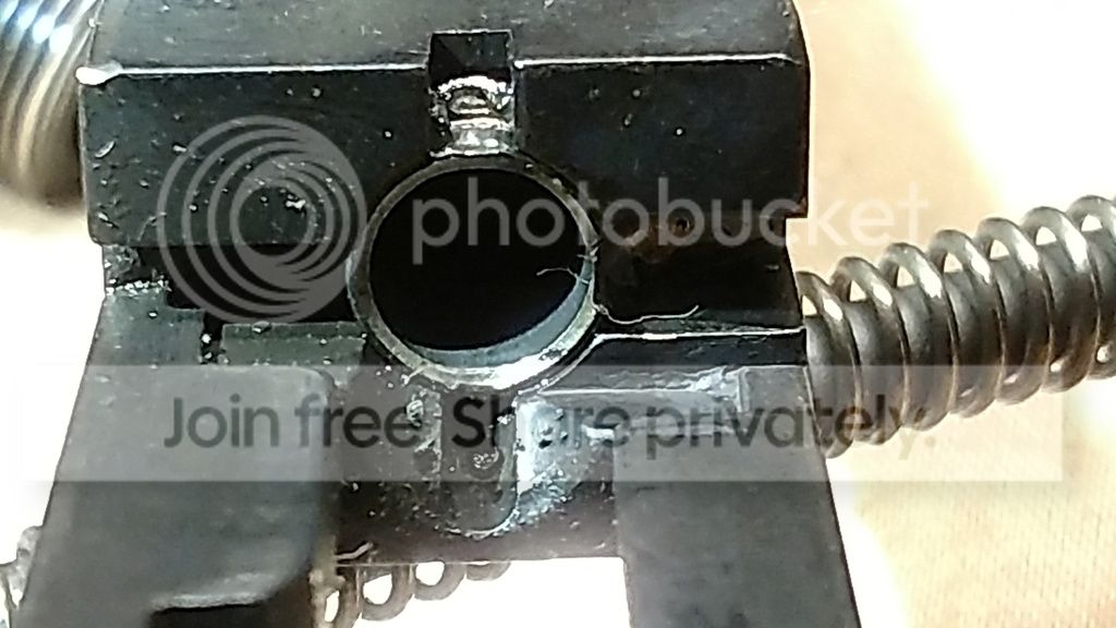

The front of my bolt seems to be peening on something. Left side in this picture, right side is charging handle and Mr. Lage said that shouldn't affect function.
Funny thing is that I caught the extractor plunger and spring in my brass catcher but the claw was inside the upper after the OOBD. My local gunsmith has looked at the chamber to verify that the lead build up is gone so I'm looking for any other ideas. Maybe it's time to give the good Lage folks a call...

I did notice some build up that I cannot remove even with a dental pick in the firing pin channel and some wear on the right side where the extractor goes. Maybe this is causing alignment issues or preventing the bolt from traveling fully forward into battery? I'm going to try a different brand of ammo and see if anything changes.

The extractor groove area in your pix looks fine. When the barrel is installed, there are exposed threads in the extractor groove area. This area is ground with a small ball grinding bit. This allows the extractor to get closer to the rim.
