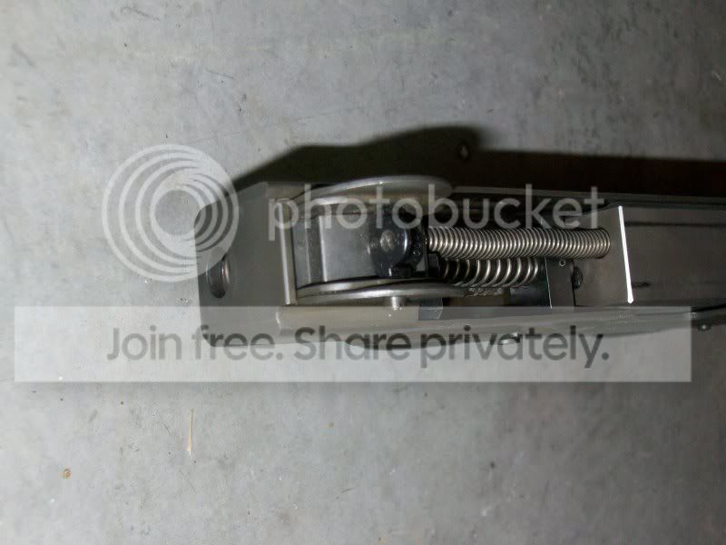

Haha I think the most promising belt fed type arrangement for this upper would be the Colt / Ciener conversion. It requires no top cover. Some mods to the upper / carrier, but certainly could be doable (potentially). I don't mean for this to muddy up this thread. Just food for thought.
