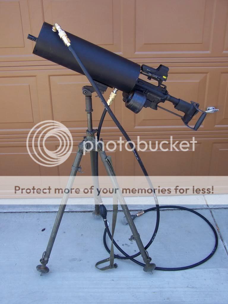

Speaking from personal experience with water cooled M16, direct impingement is the route I chose. Long or short stroke piston mechanism must vent the gas right where I wanted the water jacket to be. DI vents back at the receiver. It does require another possible point for the water jacket to leak. Instead of a roll pin, I used a bolt to hold the gas tube in place. I also silver sodered the gas tube to the gas block.
The one thing I had not thought of is the water around the gas tube reduced the volume of the gas going to the bolt group. I had to open the gas port in the barrel three numbered drill bit sizes to get the action to function with the jacket full of water. This is my water cooled project before Valkyrie belt feed conversion:
It would seem to me, that an "upper" for a MAC style RR was based on the AR DI system, a similar set up could be done. After the 500 rd burst I linked to, the water jacket was warm but not hot. I could leave my hand on it. So open bolt or closed bolt, with a water jacket, I doubt the barrel would get hot enough to have cook off issues.

Where did you pick up the tripod? I'd like to start searching for a tripod.

Thanks vegas. These mg42 tripods don't seem to easy to find based on initial search. I will keep hunting.
2,959
There was a pile of them imported about 10 years ago. I bought several. I think the the least I paid was $125.00. Vegas has told me many times. If you see it it available, buy all that you can, especially surplus. There is a brand new one on GB http://www.gunbroker.com/item/627905482 with shipping for $80 and a buy it now price of $399. It looks like a the seller has a couple of them.
ETA there is another at https://www.apexgunparts.com/mg3-anti-aircraft-tripod-very-good.html if you are interested.
