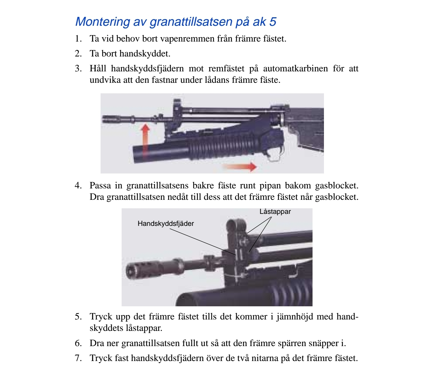

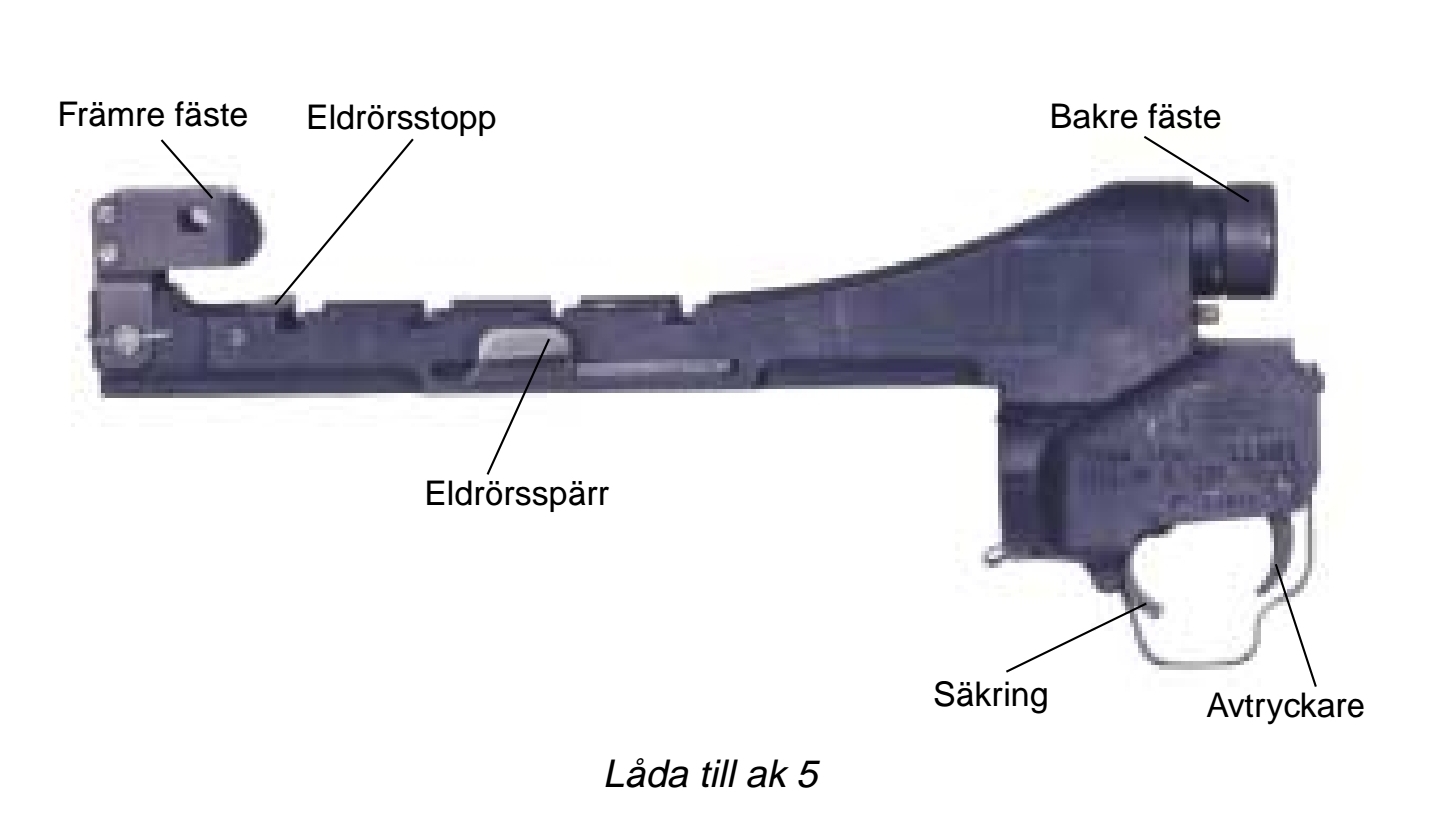

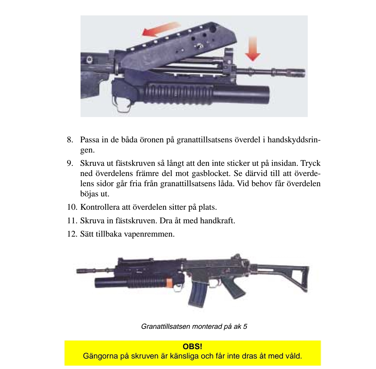

I was able to find a manual from the Swedish army of the M203 for the AK5 which shows the mounting method and hardware. I'm sure it would be next to impossible to get the hardware here, but the front and rear adapter pieces don't look like they would be difficult to fabricate for a knowledgeable machinist. Rear is a simple ring that adapts the diameter of the barrel nut to that of the M203 receiver, and front is a bracket that snaps over the handguard lugs. A simple handguard could be 3D printed.
Here are few photos from the manual:
