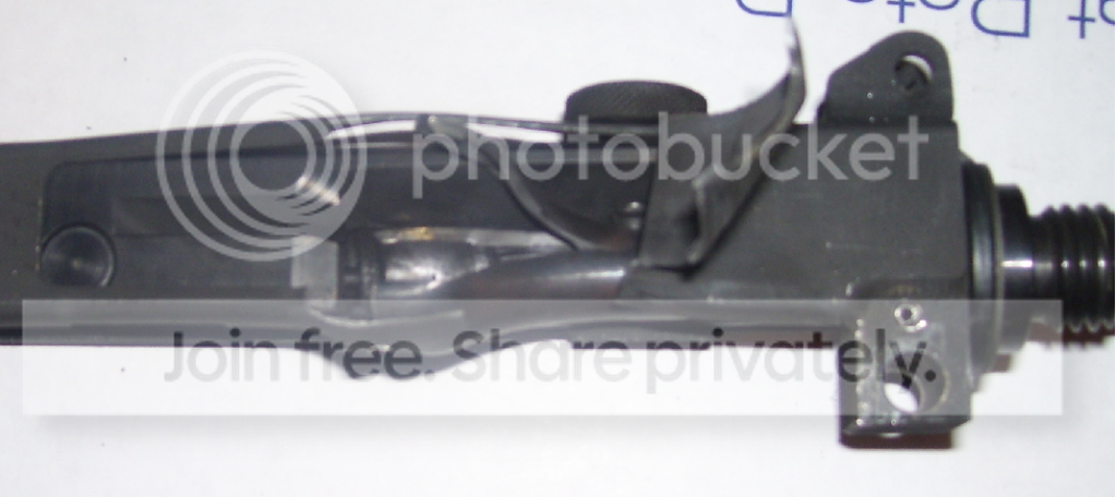

Thanks for your all your input. Unfortunately it's something that happens so violently that its hard to recall the detail of how exactly it went down. While I find it hard to believe such a light load of only 3.4gr could cause so much destruction, and there be no bullets lodged in the barrel, with no damage to 12 inches worth of suppressor baffles, it does seem like has to be the most likely cause. I wouldn't think so normally, but the fact that it failed right before the final shot sure it makes it seem so. Either way, no one was hurt, my gun can be (should be) repairable, and I can walk away from it with a lesson to be even more mindful of my loading even when I thought I was doing it very cautiously already. Hopefully others will take something away from this and remember that no matter how confident you are in your loading abilities thy things can still go overlooked and/or go wrong.

A question for those with a little more experience/knowledge. Doesn't it seem like a lot of damage for a double load in an open bolt scenario? I would expect the excess energy to go towards throwing the bolt back faster and also escaping out the ejection port. Wouldn't it be more likely that the energy causing the barrel eruption would have to come from a second bullet encountering a lodged bullet? I am far from an expert but that's how I am seeing it.
edit - posted without refreshing to see prior posts
One thing to consider with the damage done to the upper is the original style barrels are not as robust as say Richards barrels.

That round had to be fully loaded into the barrel to do that kind of damage, I guess it comes with the territory, just sad to see an NFA gun get beat up like that. Just be glad it wasn't an MP5.
I dont think an mp5 would be so easy to repair if you could repair it?

Your gun can be fixed, been there, twice. WWB once, 147 subs once. The lower can be squared and fixed. Mil the barrel off to free the bolt and you should be able to save everything except the Barrel / Upper receiver.
What he says.. dont waste your time with 1 of them OE M11/9 barrel, buy a LAGE barrel and cut out front the way you want it.. I went so far for fun to cut an Uzi SMG barrel to spin into an M11/9 upper, whole lot stronger steel than that of an OE M11/9 black barrel
