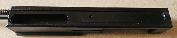

I'm still new to MG's and open bolts, so this may be a dumb question, but I noticed the Max 10/31 bolt has a pretty large slot at the top. Would the RPM change noticeably if I were to have a drop in tungsten weight machined? It would be pretty cool to have an MP-40 rate of fire, but there may be some purpose to the machined slot. Thanks for any input!20230805_163633.jpg
1,332
What would the weight of the insert be and what is the weight of the bolt now?
Make sure to not go too heavy as to make it short stroke or fail to lock back with the sear.

I could be wrong, but I believe if you made the bolt heavier (such as with a tungsten insert) and had a lighter recoil spring (such as through replacement or modification of the recoil spring), you could slow the ROF somewhat further than with extra weights alone.

I just got the tungsten weights in today and they fit with very little movement. It adds a total of 3oz to the bolt weight. I'll post some updates after I try it out. I dont have a way of measuring the RPM, so ill try to record a video if it if I can.20230809_171727.jpg

Alright, I finally got around to testing today. Attached is a pic of the bolt and a cast lead spacer to keep the weights from moving as much. I'll post video links to the original configuration and the one with weights.

I tried to calculate the RPM and my best guess using an audio app on my phone and some math is about 535 RPM. It was extremely easy to control and I'm likely going to shoot it in this configuration for the most part from now on.
