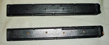

I put 20 rounds in my Butler Creek loader and them put a mark with a sharpie. When I load a mag I grab enough to fill it to that mark, load those then repeat. Then you know you have 40 rounds in the mag. (I actually put in 18 the second time and only fill mine to 38)
I also drilled witness holes in my mags, one at first to test for interference then the rest. All run prefect and now I can tell, roughly, how many rounds left in the mag.

Just a note about the mags and B.C. loader. I loaded all 7 tonight in advance of my child bride blowing through a ton of ammo tomorrow at the club. I noticed the original mags we've already used loaded much easier than the new mags I received yesterday, and one in particular was a real bugger to load. I unloaded it by hand and tried reloading it again thinking I had crossed some rims. It was the same. I'm hoping it's not problematic and I expect it'll loosen up with some use. So this is just a heads up that the new mags will likely need some breaking in before they are easy to load with the Butler Creek loader but I'd be interested in other's experience on this subject.
*It's worth noting that Klyph12 had a great idea about marking the 20 round spot on the B.C. loader. I did that today and I'm also under loading the mags by a couple of rounds for reliability and to prevent undue loading of the springs or potentially crack or stress the mags. I know some folks aren't happy unless or until they cram a magazine to it's absolutely capacity but I'm not one of those people. I used a black Sharpie to mark both sides of the loader and it's a worth while mod in my opinion. Thanks Klyph! Nice tip! A simple solution to keeping track of the rounds going in the mags that never would have occurred to me. I would be interested in seeing and hearing a little more on your witness holes if possible. What shape and size? Did you use a drill and bit? How many holes and did you do both sides of the mag or did you go with the front or rear?

Witness holes
It is impossible to see though the mags, so loaded one without the spring to get an idea of where the last round would be, and marked it. Then I just eyeballed half way to the top then split that in half, ending with 5 holes total. (3/16 bit) I have 6 mags after test firing the first one, I switched to 4 holes using the writing on the mag to put the holes in approximately the same place. I only put holes on one side. It was not very exact, but close enough for my use. Most of the time they are shot empty, but this will give an idea of how many rounds are left. BTW, the holes required no clean up on the inside, I just drilled, loaded and ran them.
The top mag is empty and bottom has 39 rounds in it,
hope the pic shows
