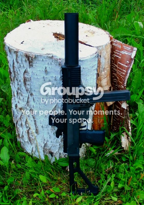

Here's my 31A Mk I shorty. A saw and file and a bit of measuring is all it took. US Machine-gun had a 9mm mac barrel for sale with 1/2x28 threads a few months ago for around $100 that was already cut back to the flange. That+60 minutes of your time and you're there.
That said, I'm going to have to get one of these when gun funds allow. Jackie is on my phone's contact list (I can stop anytime I want to, honest).
That's awesome. Really.

So you just cut the front part off at the trunion and cut the grip to match? I will try this when I am 100% I wont screw it up. I know I can come here if i have any questions.
Cocked&Locked, I cut about 1.8" from the forward extension of the top rail, leaving just enough for the grip to index on. Cut the grip with a fine blade on a chop saw after making sure it was shimmed level. I had a spare lage barrel cut and threaded but the USMG used one is definitely cheaper if still available.
The only draw back is that it is awkward to reach around a drum without a vertical grip. I like coffins anyway so not a big issue.
