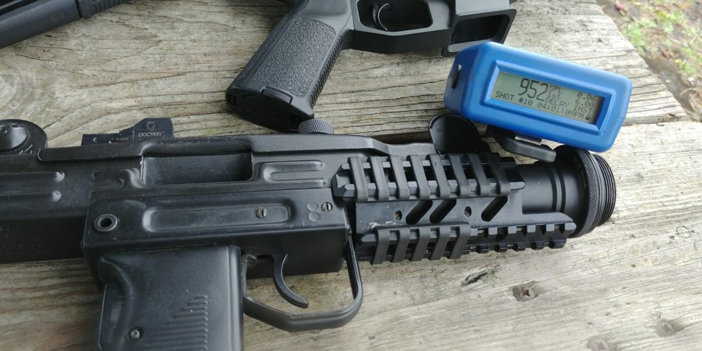

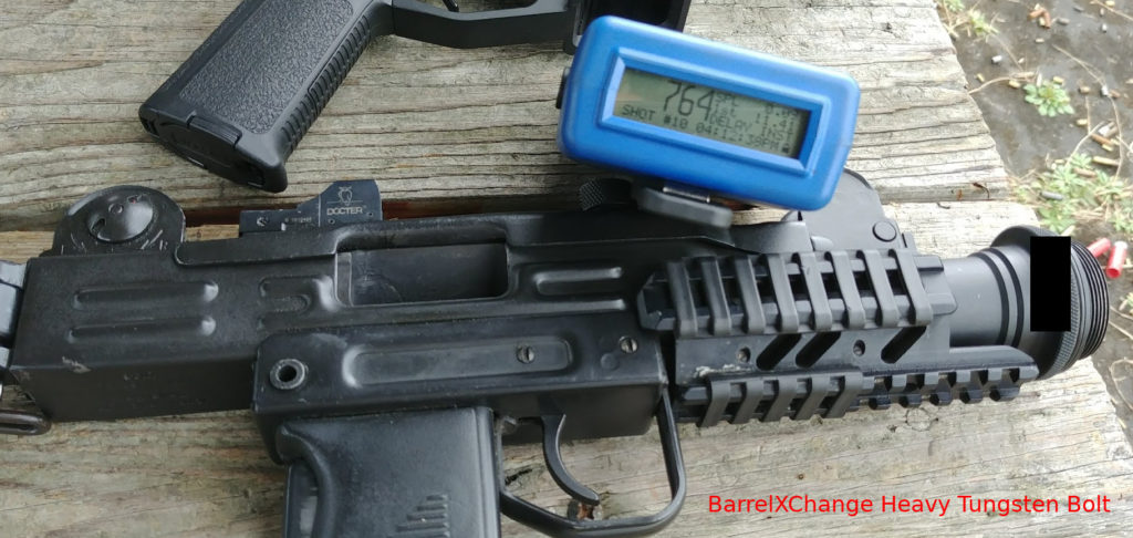

I took it out a few months ago and this is with my reloads 147Gr reloads
standard bolt:
barrelxchange

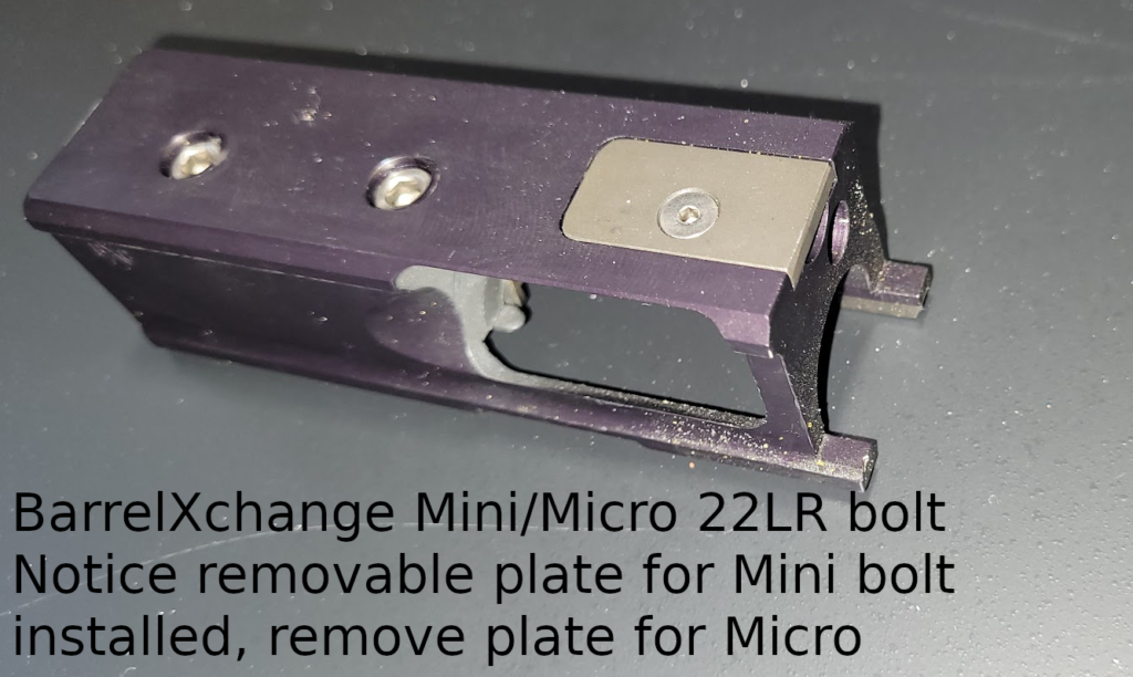

For convenience, here is the picture I posted in there:

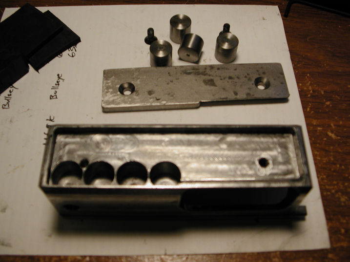

I also just pulled out my old BarrelXChange Mini/Micro 22LR bolt.
You can contrast that with how the heavy 9mm bolt is made below. I haven't seen how Troy does it for the heavy bolt but would assume a similar setup where he has a removable plate and maybe an additional hole to hold the top tungsten plate.
Unfortunately I don't believe so. For now, after MUCH soul searching, I went ahead and ordered without cuts. Troy got back to me and said we could cut the bolts later. If it were possible to get a removable plate as you describe, I would have been all over that!!! With all the guys out there that have both Mini and Micro guns, you'd think that it would be popular? The idea of having separate top covers doesn't thrill me. Just more expensive extra parts to keep track of.

To answer the questions above.
As far as I know and you would have to check with Rover Dave. IMI only prototyped the heavy bolt. It never went into production.
Micro charging handle cut is done after the tungsten plate is fitted. It is a narrow notch with just enough clearance to work properly.
The heavy bolts are not adaptable to the micro cut and mini insert as on the 22 bolts.
The screw that would hold the insert in place (6-40) would shear off during reciprocation due to the weight of the insert.
In this case dedicated is best.
