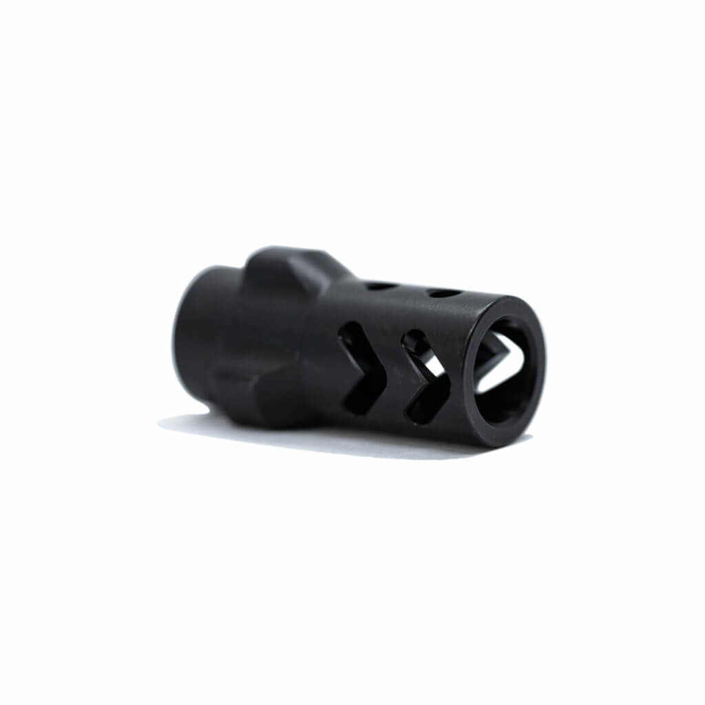

This is assuming you've got a 1/2x28 thread going, but this seems to combine the best of both worlds. Suppressor quick attach but also some muzzle brake aspects:
https://angstadtarms.com/product/3-lug-muzzle-brake/

I have run an Angstadt (sp?) 3lug flash hider with two different cans using the silencerco flush 3 lug adapter and the ports seem to get the adapter stuck pretty easily on my AKV. Have you experienced this?

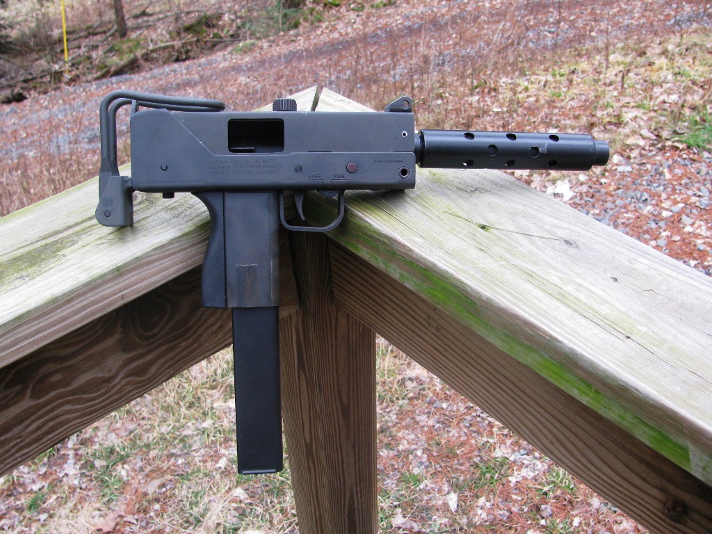

I use a traditional Carlson Compensator for 9mm. It removes most of the muzzle rise and replaces it with a lessor amount of muzzle dip. At one time, Richard Lage posted a slow motion video of that comp along with a comparison video of the standard flash hider showing its effectiveness. More recently when I had spoken to Richard, he had gone back to a regular flash hider. I guess it's just a matter of personal preference. Anyway, another Carlson comp (the first one shown in this thread) seems to show very little muzzle rise):
http://www.uzitalk.com/forums/showthread.php?45890-Two-new-compensator-flash-hiders-from-Carlson

+1 Carlson Comp
