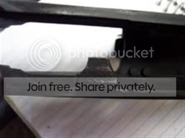

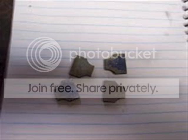

Tenngalil sent me these pics,and wanted me to post for your enjoyment
GOH
Apr 27, 2010
19
Laramie WY
Did Jeff make these? Also, what technique is used to weld them into place? Enquiring minds want to know.
Tenngalil
Apr 27, 2007
395
McMinnville Tennessee
The replacement ejectors are EDM'd from 4140 air hard plate.
i left .05 on the edge that fits inside the bolt for fitting/squaring up after it's welded in.
i mill out the old lug, lay the rec. on the side and mill through the rail.
i ground a 4 flute cutter undersize so the new lug has a light press fit to hold it in place.
Tig at low heat and finish machine using an alignment/timing guage i made using an IMI rec.
Double check the heat treat at the out side edge- usually ends up at 45-50 rockwell.
Takes time but the results are great- i'm getting the feel for making the empty cases do weird stuff like out and down or straight out to the right patterns.
