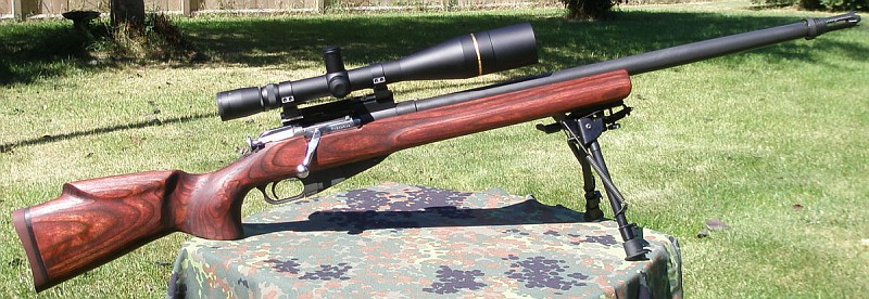

This past summer I picked up a Leupold VX-3 Long Range Target Rifle Scope from MidwayUSA for use on my custom Mosin target rifle. It's got a 30mm tube, 6.5-20x, 50mm objective, and side focus. I went with the Leupold varmint hunters reticle, but there are other reticles offered, too.
http://www.midwayusa.com/product/38...50mm-side-focus-varmint-hunters-reticle-matte
I went with a set of Leupold's medium 30mm QRW rings. May have been able to go with the low rings… but they work.
The VX-3 is a pretty solid scope and it comes in several different configurations. I've not had a chance to shoot this rifle beyond 300 yards yet, but so far I've been nothing but extremely pleased with everything about this scope. I had looked at Nightforce and a few others, but this Leupold seemed to offer the most bang for the buck and didn't break the bank along the way.
