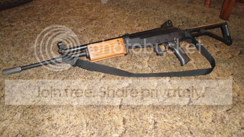

Ohio Rapid Fire (ORF) is notoriously known for out of spec receivers, and improper heat treatment. They can be made into nice clone but usually require some work. I have a Blackthorne kit on an ORF receiver that was gone through by the Firing Line in Oklahoma. I have over $1800 bucks in it unfortunately, so consider yourself lucky for finding such a deal. I see no evidence of yours being ORF.
gbfirearmsales
Feedback: 1 / 1 / 0
Dec 31, 2008
469
With the small hole on the left, it is then not an ORF receiver but, one thing is clear...
It is not a Springfield Armory rifle is it? Can we agree that it is aftermarket, third party engraving done on that rifle to create the illusion of a factory Springfield?

Extra pictures would help of course, but I'm going to venture a guess that is an IMI receiver. I have never seen an ORF with the area for a scope mount milled correctly such as this one. As for the markings, I have no idea. As for price, I'll just say I have much more in ARM clone.
Like i said, it looks like a custom job to me. If the receiver is modified, the scope mount could have been apart of job as well. I realize that's a bit of a long-shot, but who knows. I've heard stranger stories

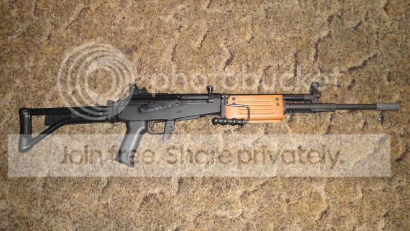

Sorry Guys I didnt get a chance to take new pictures. I had taken these the other day, that might help a little more. I will get more pictures up and a little better quality.
The only thing that really concerns is this rifle legal?
Thanks for all the replys I was really lost before.

Need to see the inside of the rifle, top view with cover removed and need to see if the fire control parts have been changed to US made, if the pistol grip or foreward handguard is US made etc. to know if the rifle is legal under 922r.
That muzzlebrake is not factory IMI is it?

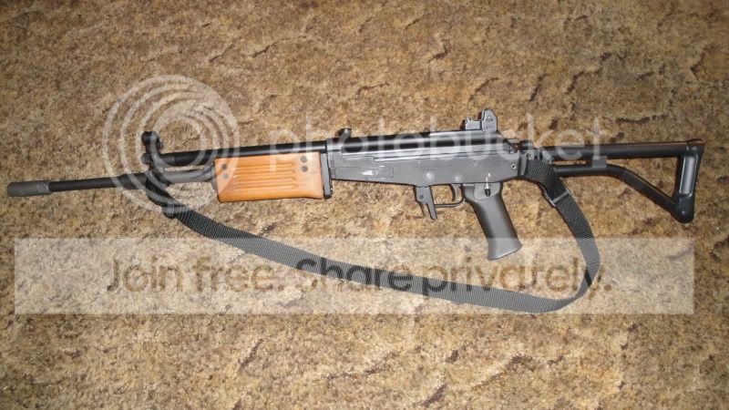

I would bet this is one of the last Springfield imports, note the neutered muzzle device and bayonet lug. Maybe even built with a stripped receiver?
You want to know for sure? Call Springfield. They told me the year and month my SAR8 was imported. The customer service number is on their website, they should be able to give you some info about how it was brought in, if it was one of theirs.

it almost looks like a brake from a FAL. I have a similar looking one on my IMBEL.
My question is DOES IT SHOOT? If it shoots well and reliably, and if YOU are happy with it and think you got a deal, so what? At the very least you have a wonderful conversation piece that is (hopefully) very accurate, at best you got a kick-ass deal.
I would call Springfield just to see if you can get more information on it, just for that conversation part.

Does the serial number on the topcover match the receiver?
Does the hammer pin extend far enough from the receiver to act as a stop for the selector.
These are typically true for semi galils that were imported as complete guns.

If the owner will pop the top cover off, and remove the bolt carrier and gas tube and show photos from the top, it is easier to see how the gas tube slot is milled, and how the rear cover slot is milled as well as into the locking lug area etc. and such. It would be easier to see if it looks like IMI work of aftermarket. Regardless, something I have said before and I will repeat now. If the owner is happy with the rifle, how it looks, shoots and such...and he could not afford to drop $2k on a factory built IMI, then this rifle is in fact a good deal for him.
devoeski
Jan 23, 2011
9
It's not an Orf,Orf golani sporter are safe position forward fire position back. This is opposite. However isn't it possible this is authentic IMI but changed because its not 922 and therefore illegal?
