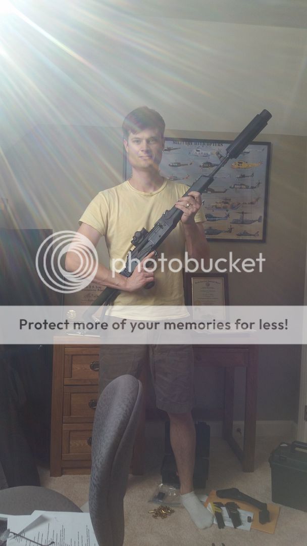

Original Vector M92 factory SBR + JPoint RDS w/Wings
