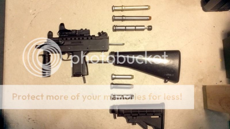

You can see I've got multiple options for playing with buffer weights and styles, as well as spring weights and lengths. Anything from high-speed to stupid slow, and everything in between.
Having said that, how often are you really going to want to adjust your ROF by 50 RPM? If you're like me, you want one or two speeds and you're good to go. Others have said it, and I tend to agree that if Lage had introduced his upper early enough, the TASK system would never have been invented. There would have been no need. Had I started with a Lage upper, I wouldn't have bothered to do the TASK conversion.

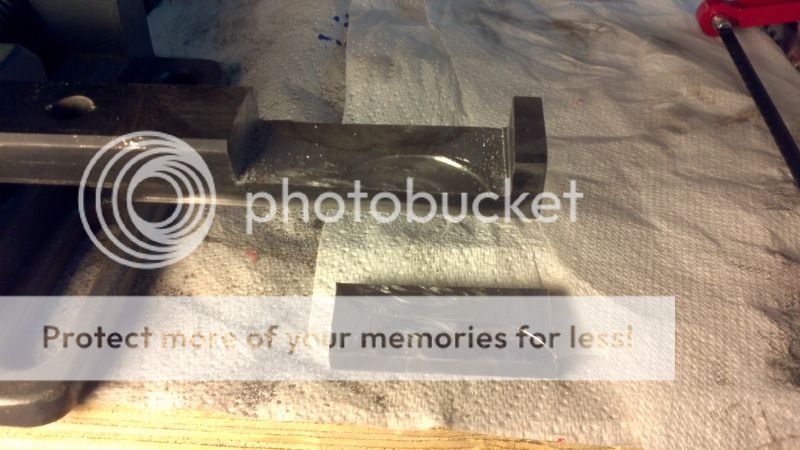

If you don't like the rates of fire of the standard Lage bolt offerings, take a heavy bolt weight and start hacking until you get the ROF you want. I made my own Tac bolt with nothing but a dremil cutoff tool and a file.

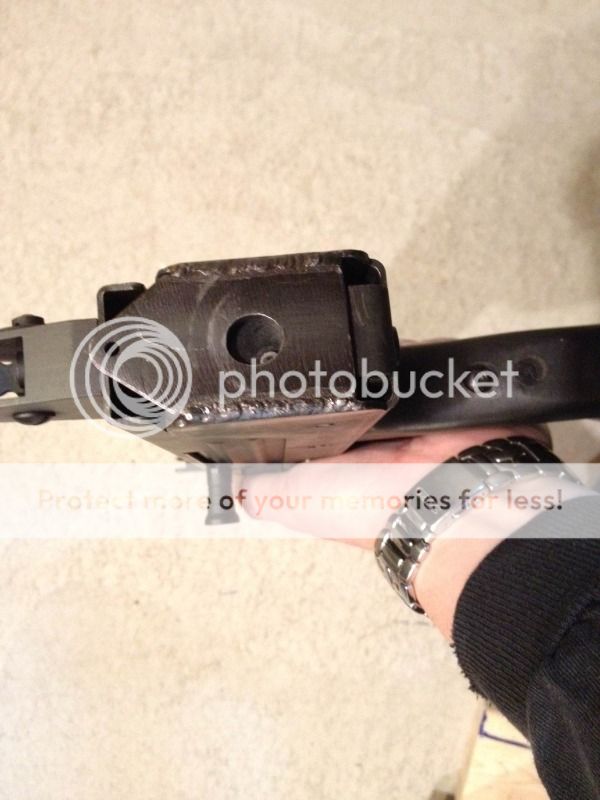

What appeals to me about the TASK is the relative cheap price and the ability to do it myself also it seems to keep it compact where as the Max makes it a bit longer. The only thing that concerns me, does the hole in the rear of the receiver I have to drill would that lower the value of the gun or keep me from running it stock (or otherwise limit me from what I can do with a stock M11/9?), would I always have to have the AR adapter on?
2,843
If / when the S.A.B.R.E. .223 upper is released, I see a lot more M11/9s getting the back plate drilled. What I don't know yet is if the hole is in the same place for both conversions.
As for the TASK conversion being more compact - not so much. While the Lage upper is longer, you have the option there of using a folding stock. With the TASK conversion, you are stuck with an M4 stock as your shortest option. (I prefer the A1 stock, as it allows heavier buffers).
The hole won't keep you from being able to run a stock or Lage upper. The back plate that holds the recoil rod and ejector covers the hole. It runs fine with the hole there.
As you can see, my back plate had been rewelded some time in the past anyway. So I wasn't really worried about loosing any "value" by poking a hole in it. Worst case, I just cut the back plate off and weld a new one on.
