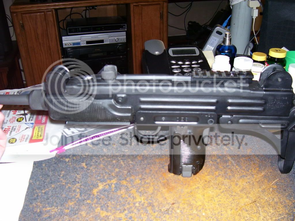

finished park with black enamel paint over : note topcover black park only
the grips are all used i picked cheap and install a rail for VFG

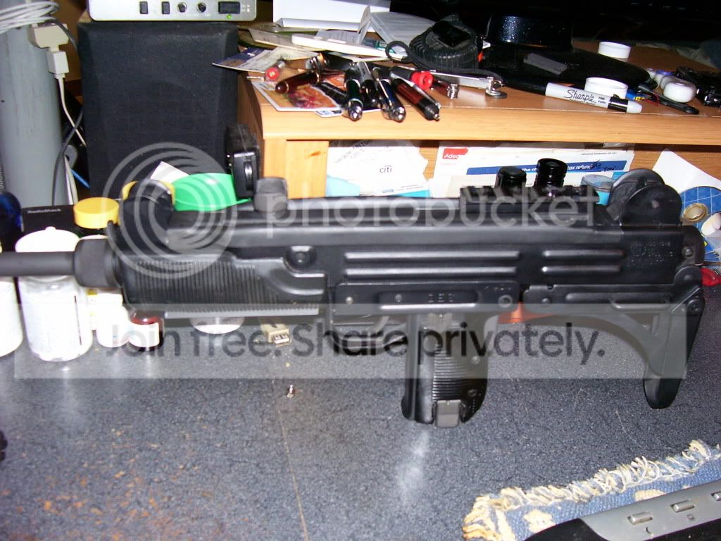

I've had good results with the Parkerizing 'kits' from Shooters Solutions. The NoDak receiver came out a nice dark gray. :)
