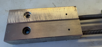

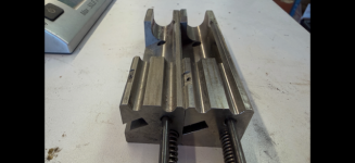

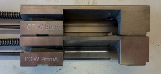

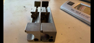

They both shoot great.
This CFW is the final version with the ”dot” between the letters versus the new PSW.
The PSW does not have a provision for the detent if using a top charging upper.
Yes dirty, but can still see some differences.
-The firing pin is slightly taller on the PSW
-The magazine channel cuts are larger on PSW
-The CFW has more of a radius at the breech face

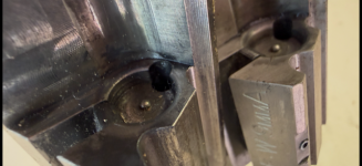

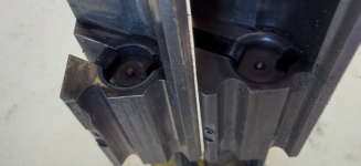

PSW on the left
PSW on the right, different extractor channel slopes

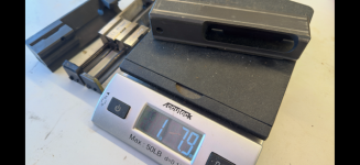

PSW on top

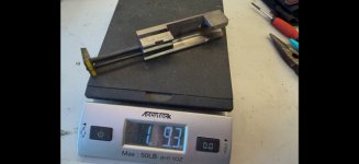

PSW weight

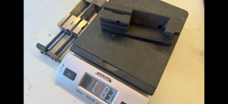

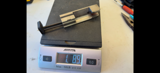

CFW weight
MAC10 weight (stripped)

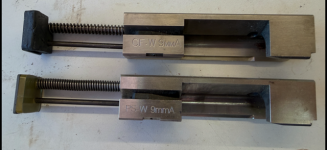

Thank you for the pictures. Looking at the first two pictures in the thread, there seems to be a lot more spring coils in the PS bolt with a smaller diameter wire in the PS bolt. As I recall Tom had custom springs wound for the CF(W) bolts. Do you have a standard bolt? If so, how does the PS bolt recoil spring compare to the standard steel bolt recoil spring?
3,633
You’re welcome.

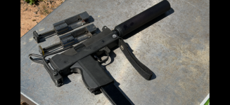

My CFW had a much cut down spring in comparison to the PSW (not mine) that had a different spring trying all kinds of variations. I didn’t mention springs because that’s a variable and I was only interested in the base physical differences. I was there for pleasure shooting this time, only a few spring swaps were tried. I snapped a few pictures to share.
Between myself and friend we’ve had every bolt from the first version that had a cube tacked on to every one of Tom’s bolts before they were up for sale while testing. So a lot of ground has already been covered both m11 and m11/9.
The PSW bolt feels like a CFWa if you were to put the same spring. Any minuscule difference in weight isn’t something you will notice in rof. The PSW is reliable, no issues with function.

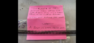

Side note for anyone that didn’t see this yet… from Tom during a-bolt testing.

We set the bolt up to use the easiest to get and cheapest charging handle which is the hockey puck for the M11/NINE and we sell it on our website if anyone needs one. We were trying to make these bolts as inexpensively as possible to keep the cost down. If we had made with the provision for the detent, it would have increased the cost.
The springs are the same. Perhaps the spring in the bolt pictured has more coils, that may very well be the case, but the spring itself it the exact same spring as what Tom used. All of the PSW bolts have the same spring they're just cut to different lengths depending which gun we set the bolt up for.
Yes, Tom did have custom springs made, but they didn't work. He called them "wonder springs" because he wondered what he would do with 1000 unusable springs. He sent them to us in hopes that one day we would find a use for them. They are in my office waiting for their day to shine.
